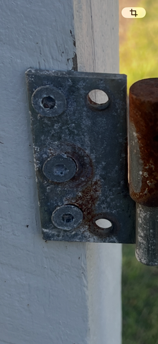

Thank you @AlanM52 - I have been working on getting the screws out but most of the left side ones will
not budge, and the thread is gone on two of them.
I have sprayed them with wd40, and used a combination of tools to get some leverage on them, that’s how I managed the right side, but the left side has less room to manoeuvre and they seem much more stuck.
Have you got any tips for me?
Re: How to replace rusted gate hinges?
Since the heads are slightly proud of the hinge plate, you might be able to grab them from the side with a pair of multi-grip pliers @Rachel20. It will take a while to work them out, but it could get you out of the situation.

Hi @Rachel20,
I am not surprised the screws are 'frozen' and should have mentioned about that possibility.
Can you inform us what tools were used to remove the other screws and while waiting for that...
Hard to identify from the photos but @MitchellMc & @JacobZ  they look like this.
Rachel... I use a 'best bet' cordless Impact Driver but with cost in mind you could use this:
Asking @MitchellMc & @JacobZ to find one with the correct hex socket or that one with adaptor.
If you can't remove all of the screws then also try this.
Use a softer flame and directly heat the screw head for about five seconds.
Wait for a bit and try again, the intention is the heat will 'crack' the frozen bond.
That usually works for me but... I am alternating with heat and impact driver.
Let us know how it works out...
