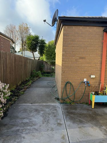

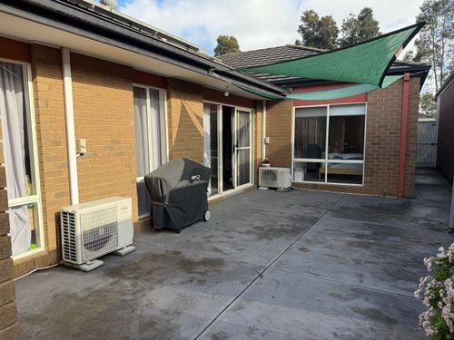

I have been wanting to revive the concrete floor of my outdoor area. I love the idea of doing crazy paving on the current floor but a friend I know I might have to check if that will block the weep holes.
Is there anyway to avoid that? or other suggestions on how to revive the floor that looks nice like crazy paving.

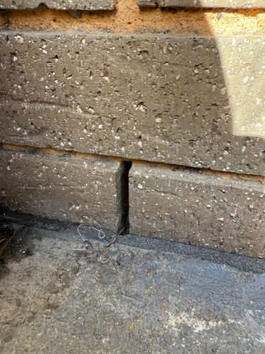

Is it possible to do crazy paving for the area in the middle and add some edging with pebbles around the weep holes?
Or any suggestions on how can we make some nice pattern to the floor?
These are our weep holes.
Thanks!
T.
Re: Revive outdoor concrete floor
Hello @Tsu
I'm afraid even partial coverage with pebbles or gravel is not recommended. Weep holes are crucial for ventilation and drainage in brick walls, and obstructing them can lead to moisture buildup, rot, and potential structural damage.

You do have a blank slate to work with :smile: Which is good tho I will admit I am not a huge fan of painting concrete :smile: I have had to remove old flaky concrete too many times. (yes I have repainted my patio and bessa block wall lol The idea I have for your area is a bit outside the box painting/old school design.
My Grandma loved painting her small patio, she would paint it when my Grandfather was at work doing shiftwork so it was a done and dusted deal when he got home... She would hand paint chequred squares across the patio and steps, looking back the grandkids were tasked every few years with repainting the squares. Think large chessboard sized squares and you have the pattern. They started off all different colours (paint pot samples) and ended up black and white by the time I was a teenager. It gave a very different look and was calming.
You could do something similar with your area, the whole lot dosnt have to be that way, it can have a mixture of @EricL's paint and then maybe the design above in the middle,, or pathway even.
