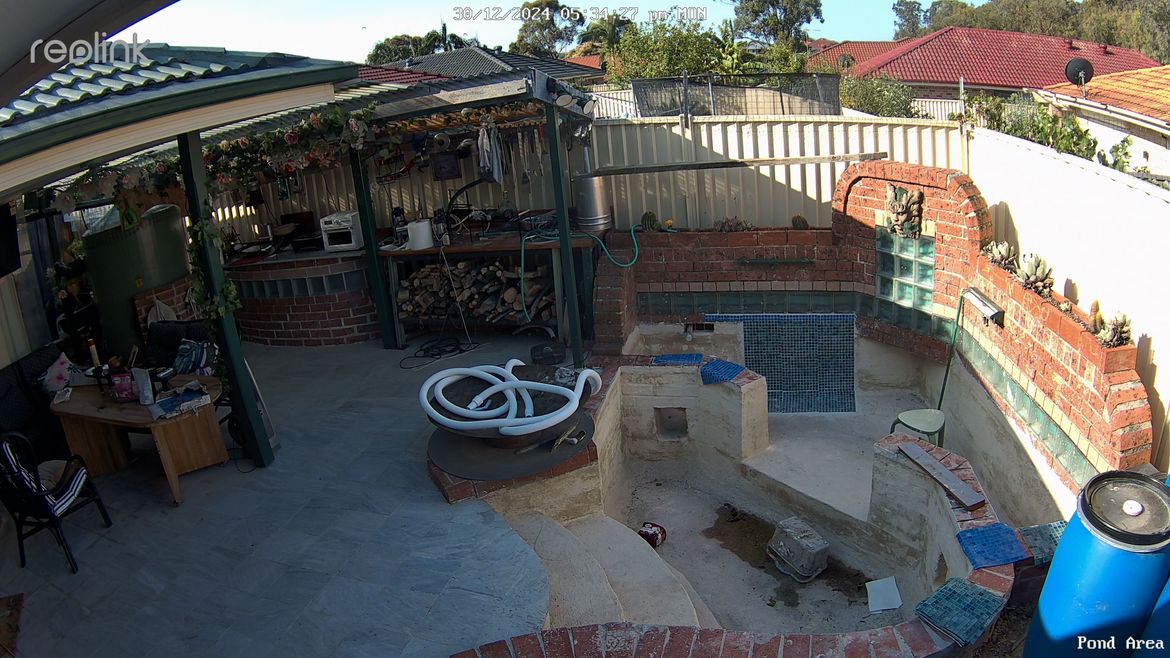

9000L cement and brick pond no cracks
9000L Cement and brick pond built to last and not fail like under designed concrete ponds often do in earlier attempts as water is very heavy that is 9 tonnes of water on top of a cement slab need to get that one right first time.
So how thick should the concrete be for my pond.?
I used 300 mm thick double steel reenfored concrete for the cement base with half round fillet corners with mesh webbing to transition water weight/pressure gradually to brick walls , Gravity goes straight down so regular double brick walls are not under huge strain.
Will it fail? NO I build to have it out last me and beyond no short cuts on key structural projects. Back yard pools tend to be around 150 to 200mm in the base depending on the concreter.
Stage 1 is the top section of the pond build when I had less ideas of fishes needs. Gold fish where fine koi where wallowing in the shallows. I did have a 10mm thick aquarium glass front originally. To explain the wings of bricks in the pond. It looked good.
Stage 2 is the lower section Koi need a deeper cooler water for higher fishy happiness. Koi treated right can live 30 plus years thats longer than cats dogs and many pets and they do learn and remember people contrary to many peoples thoughts of brainless animals.
It was challenging marrying the two pond stages as I had to undo bricks and interlock them so it wasn't a Butt join doomed to a leak failure.
Cut some holes in the brick wings for better water flow also for fish interest rather than a box of water.
I fully filled the pond to test the concrete for 2 months Rock Solid is the verdict , Stage one is 15 years old stood the test of water and time, Now I am starting to add a purly cosmetic layer of glass tiles. AS why go to all this trouble just to look at concrete.
The Rendered looking coating is several layers of Silasec over the top of bondcrete sealing layers this stuff is pure gold as it is UV safe as all concrete surfaces. Totally water proof was my goal for a long lasting pond solution all else are fails.
This journey began in earnist as the first pond stage was painted with crommelin blue waterproofing made for ponds was not stated as UV proof. 2 years later and it peeled and failed. Never assume a product is UV safe unless they state clearly it is. So I was badly bitten.
