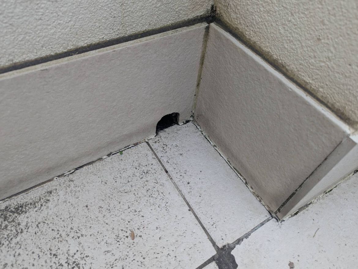

Our balcony waterproofing was redone about six years ago. If the waterproofing is still in good condition, should there be any leaking at all? I’ve also noticed some cracks in the silicone. The area where the leak was observed is at the lowest point of the balcony, where water tends to pool, and that’s also where the silicone cracks are visible. I’ll take photos and send them through when I’m home.

I completely agree that the balcony wasn’t graded correctly. We did notify them at the time they redid the balcony; the slope improved, but it’s still not good enough. After it rains, we still have to wipe the water off for it to dry.
Attached are a couple of photos of the grout. Do you think the grout needs to be replaced?

Re: How to seal a leaking outdoor balcony?
Hi @emmab1986,
From the photos, the grout itself between the tiles looks generally fine and probably doesn’t need replacing if there are no visible cracks. The main problem is actually the joint between the floor tiles and the wall tiles. It looks like the existing silicone or polyurethane seal has lifted and delaminated, leaving a gap where water can easily seep underneath.
The best approach is to remove all the old, failing sealant, thoroughly clean the tile surfaces in that joint so they’re completely free of residue, and then reseal using a high-quality flexible sealant like Sikaflex 11 FC. Apply it carefully from the floor tiles up to the wall tiles to create a continuous, watertight barrier. This should prevent water from penetrating under the tiles and help address the leaking issue.
