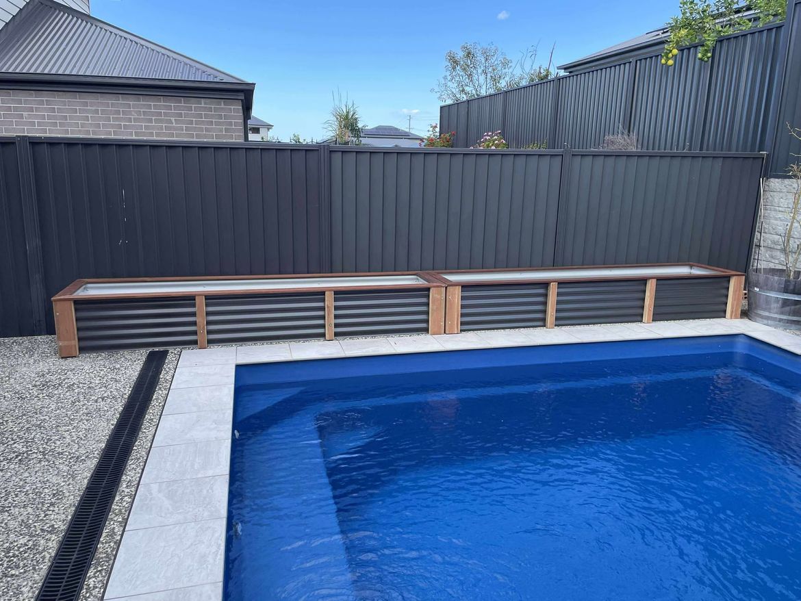

I've got some planter boxes made of colourbond that I need to seal off the front and sides.

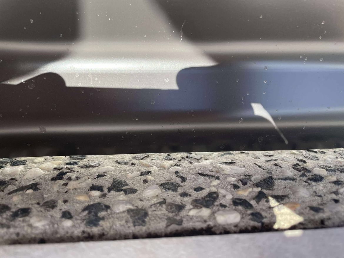

Foam backer rod or some sort of backing would certainly be a good idea, as it helps the silicone sit properly in the joint rather than just sinking into the void. The tricky part here is that you’re working with a really thin edge between the corrugated steel and the pebblecrete, so I think you’d find it hard to keep a backing rod in position. The only way I can picture it working is if you could wedge the rod underneath that thin edge, but even then it might not stay put.
Another option could be to run a strip of something like gaffer tape along the back edge against the pebblecrete. That would give you a semi-solid face to fill against with the silicone, and you could peel the tape away afterwards. The main goal is just to have something behind the gap so the silicone has a surface to form against.
If the gap isn’t too large, you might also get away with simply cutting the nozzle of the silicone tube quite wide and laying down a thick bead to bridge the space in one pass. In that case, I’d recommend applying it from the inside of the planter box so you don’t end up with a messy finish showing on the outside.
