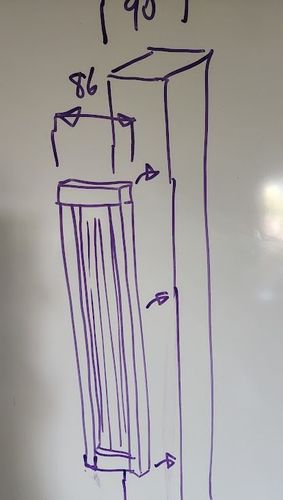

I may not have explained it properly. I have attached an image.

Welcome to the Bunnings Workshop community @simoncole55. It's terrific to have you join us, and many thanks for your question about fixing a panel.
It's great to see that @Noyade has already been assisting.
You could use angle brackets at the top and bottom to secure the panel. Rebating them into the posts will allow you to have the panel sit perfectly within the posts. I've created a rendering below to illustrate. Alternatively, with some accurate drilling and if you can access the other side of the posts, you could pre-drill and put screws through the posts and into the edge of the Merbau.

Thank you very much I think I can make this work!
