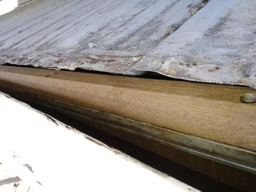

As Jacob said, photos would be helpful. From my experience, the roof frame, including already having the ceiling sheets attached to it, sits on top of the wall frame and is fastened from above before the roof cladding goes on. My caravan ('72 York), in the photos above, had timber either side of the roof with the rafters screwed to it from outside, the ceiling sheets were originally sandwiched between the wall and top.
My 1977 Millard had a similar style roof and I had to replace a rotten section, because these were built from the inside out, I had to replace the timber from the outside (trims/j rails taken off to reseal).   You can see the holes in the new timber (meranti) where I screwed it down to the wall frame. I don't have any photos of screwing the new rafters into it unfortunately but hopefully this is enough to give an idea.
The rafters are only attached to the frame, they are not attached to the above cladding to allow for flex while travelling.
