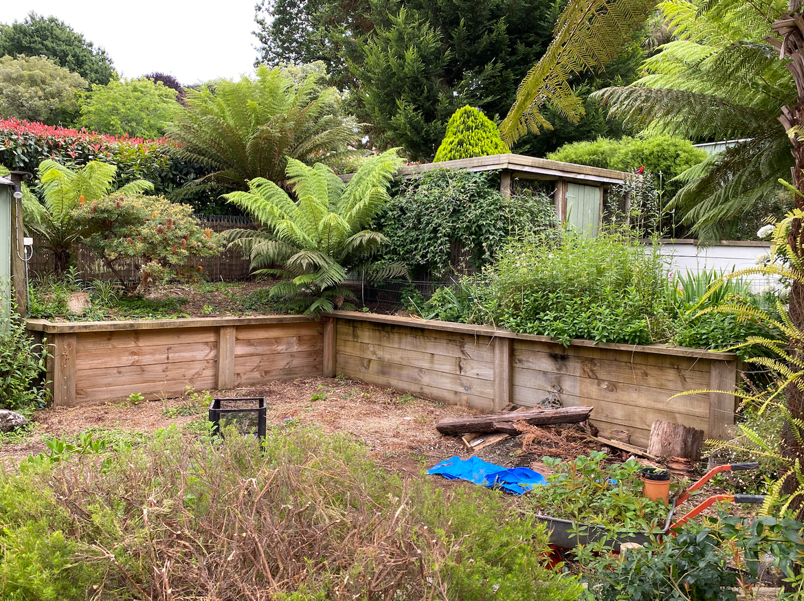

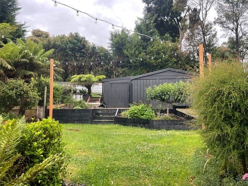

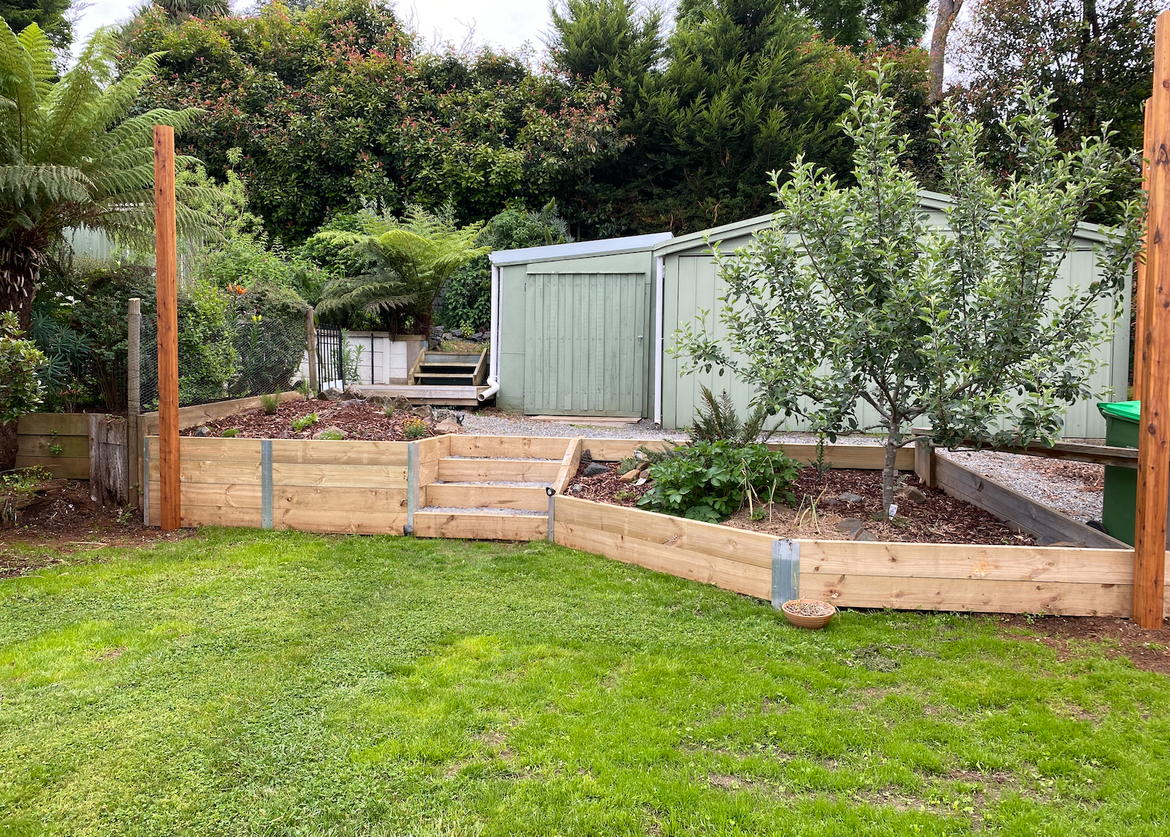

I’m seeking advice on the best product to stain my retaining walls black. I prefer a very dark shade, as my aim is to minimize visual clutter, highlight my cypress posts, and make the greenery and colorful flowers stand out against the backdrop.
Eventually, I plan to paint the shed black as well.
Which product should I use? I am conscious of the risks associated with sealing timber and understand that it needs to breathe, so I am looking for a stain that doesn’t contain oil or water.
Also, how should I prepare my older timber walls before applying the stain?
Thank you kindly.

I've read that thread and I am looking at Palm Beach Black. I do however still need to figure out how to prepare my retaining walls, especially the ones in the second picture as they are much older (not sure how old exactly  they were here when we bought the place). Any suggestions?

I suggest going with the recommendations made in the discussion and that is to use 30 Seconds 5L Outdoor Cleaner Concentrate in combination with a scrub brush and washing the surface with a pressure washer. If the stains are stubborn, I suggest a second application of the outdoor cleaner.
Please make sure to give the outdoor cleaner enough time to soak in and activate. Washing it off too soon will neutralize its effectivity.
