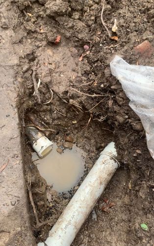

I have an old pipe that is not connected anywhere which is next to storm water pipe that runs towards road.
The issue is when it rains, water comes out of this unconnected pipe and ground gets very damp in that area.
recently I dug that area and got plumber. Plumber put a cap to the pipe and asked me to monitor if water still gets out of  pipe when it rains.
i see it still slowly fills up the area meaning water is also coming around that pipe.
This unconnected pipe is under driveway which is concrete and solid. No gravel around pipe. So, I suspect the damage to pipe is very near to the opening.
my questions is
1) how do I check the damage
 to pipe?
2) if pipe is not leaking or if I can fix that leakage, how do I connect unconnected pipe to storm water pipe so water would not flow back. Unconnected pipe is around 1-2 inch below storm water pipe.
Appreciate your help.

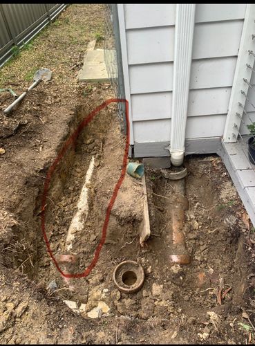

Re: How to stop ground water coming out from unconnected pipe?
Hi @Dave-1,
on the higher side of the house, I dug along old storm water pipe and found this (pic attached)
As you mentioned in your comment above, I see a plastic wrapped around a pipe and running till end of house. Then connected to a clay pipe.
is this how your Drain pipe looked?
Because when I hose down the soil along the length of the house next to fence, all the water gets into this pipe and flows all the way to the lower I.e. other side of the house next to driveway and comes out of unconnected pipe.
Looks like it acts as a French drain.
Nailbag
Home Improvement Guru
Hi @approachmhn, if plastic is actually wrapped around the pipe and not underneath or off the the side, it sounds like they were attempting to prevent water from coming out of it instead of replacing it, hence why the water is leaching. Do you have any photos?
Also is there any water coming out of the end connection in to the clay pipe?
