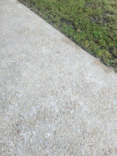

Long time observer, first time post. Recently hit a roadblock with our exposed aggegrate patio and am getting very confusing advice from various trades.

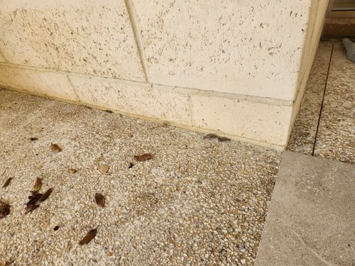

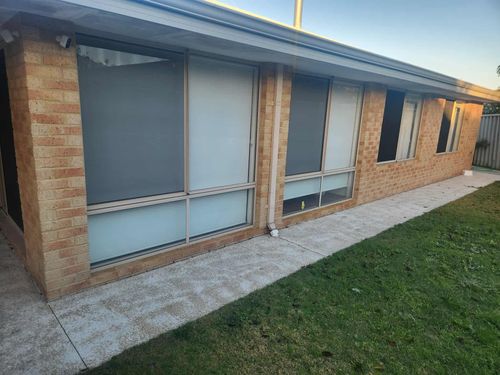

Long story short, we moved into this property with a large concrete area however the exposed agg must be quite worn as it was very sharp to walk on and my kids would cut themselves badly if they tripped. We had it honed back but unfortunately it came up very patchy and we were told it was due to the age of the concrete and the high ratio of rocks vs cement (see images). Sadly with that money down the drain we need to find another option to resurface it. We're considering tiling it but after seeing the labour costs we are mulling the idea of DIY. It's a large area (65sqm plus the rear pathway) but it is relatively flat I believe and square-ish, and has already been grinded back i.e. any previous sealant has been removed, which I understand is necessary if adhesive is applied for tiling.
The concrete I believe is over 8-10 years old. There is one big crack in the rear pathway but small fractures in the main alfresco area. Relatively flat in most areas after going over with a spirit level.
Questions:
1) I'm generally handy and have done floorboards in the past (and maybe 15yrs younger), are we insane to consider to take this on as a first time DIY tiling project?
2) Confirming that it is okay to tile right over the exposed aggregate with suitable adhesive mix?
3) Are 10mm thickness tiles strong enough to apply? Noting not all the exposed aggregate is completely flat (see images)
4) Considering 600x600 tiles, what pattern should they be laid and which corner do you start from?
5) I went into Bunnings and was told all their tiles are not suitable for outdoors, is this correct? Referring to the Duratile 600x600s.
6) What do I put on the edges to finish? Metal strips?
Thanks in advance for any advice!
Cheers,
Wei

I don't think you are crazy to take on this kind of project, although it is quite large. Tiling itself is not that hard; if you do the prep work, carefully lay things out to set yourself up for success, you should be able to produce a great result.
Yes, you can tile over this concrete, but it would be best to get the surface perfectly level before tiling. You can account for slight unevenness in the slab by using a thicker bed of adhesive, but this can cause the adhesive to dry unevenly which can weaken it. Any cracking in the adhesive can cause movement and eventually cracking in tiles, especially when using thinner tiles such as the 10mm tiles you mentioned. For these reasons, I would consider using a self-levelling compound that is suitable for outdoor applications such as Dunlop Ardit Floor Leveller prior to tiling.
If you used a thicker tile, more along the lines of a paver, you could get away with using a bed of mortar, without any additional levelling.
Generally speaking, you should lay out your tiles based on the points where the eye is drawn and foot traffic is high. In your case, everything should likely work off the door and the line of the wall that it sits in. Try to space things so that any cut tiles on either side of the space are relatively even. Snapping lines with a chalk line and dry laying your tiles before they are attached will help with visualising the area. For changes in direction, like the pathway down the side of the house, adding a strip of different, smaller tiles to create a breaker strip will allow you to adjust the layout to suit the change in direction.
For an outdoor space like this, you need to use outdoor-rated tiles like these Johnson 300 x 600mm Grey Hampton Outdoor Porcelain Floor Tiles. They have a gritty surface and are tested and given a slip rating. There are only limited options for outdoor tiles kept in stock. Our friends at Beaumont Tiles have a wider range of Outdoor Tiles. It would be worth checking out their range for more options.
For the edges, tile trims are the way to go. Something like this QEP 10mm x 3.0m Silver L Shaped Tile Trim Angle might be a good option for you.

Hi @Wei123 see below:
Questions:
A: DIY vs the cost of professional done is significant to say the least. If you're handy and prepared to take your time your starting off an exceptionally good base. I would say go for it.
A: Unless proven wrong, I would say yes. It's important to use a flexible adhesive and obviously follow the directions of the manufacturer. But personally I would consider the base you have to work from is an excellent one and instead lay pavers on a washed white sand base. This would be significantly cheaper and easier to lay.
A: I wouldn't, as you're lending yourself to cracked tiles and grout. I would be surprised if suitable external 10mm tiles are even available.
A: I would go with 450 x 450 max as being much easier to manage as well as a multiple of other reasons. use the house as your straight line reference and start at one corner wall to work along.

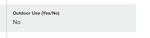

A: That is correct
A: Mortar bed or steel edging would be thew best long term.

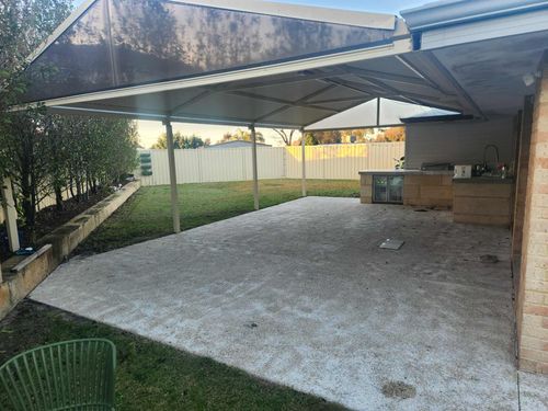

I think I'm leaning towards tiling but haven't ruled out completely the paving. Went to Beaumont tiles who recommended some outdoor tiles. Assuming I go for the tiling option, perhaps my highest uncertainty is the levelling prep stage. I feel fairly comfortable to give the laying of tiling a go but agree that the prep would need to be done well.

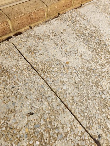

With levelling, there seems to be a fair few YouTube videos on the use of the material for indoors where there are defined walls, but not outdoors. Some questions to go with this:
1) When levelling, should I be avoiding lettting it seep through the expansion joints? If so, how do I go about this?
2) Similiar to the first question, how do I ensure I avoid the edges as I can see there is some residual expansion joints connecting the walls of the house.

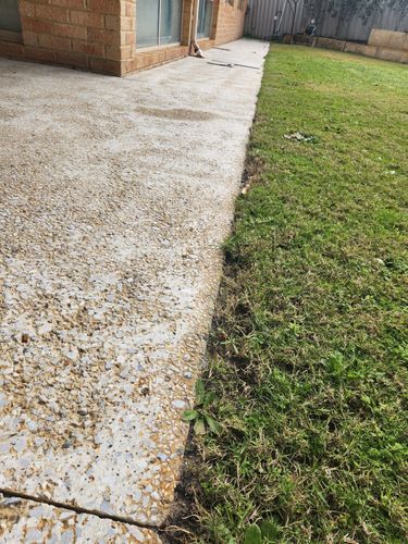

3) How do I not let the levelling material pour too much onto the grass on the outer edges? Do I build some kind of form work beforehand? If so, what is the best material to use without it sticking to the self leveller?
4) How do I protect the limestone around the bbq area from any splashes from the self leveller or is it easy to clean off any mistakes made?

Hi @Wei123
If you tile, then you will be using some form of recommended adhesive, so I would use a flexible filler like Sika 11FC.
2) Similar to the first question, how do I ensure I avoid the edges as I can see there is some residual expansion joints connecting the walls of the house.
Leave a few mm gap between the house and tile edge. This can be filled with either the same Sika product.
I wouldn't use self-levelling compound at all. You want the tiles to have a gently fall away from the house which can be achieved with the tile adhesive. But if there are substantial dips runnings length-wise just use timber against the edge of the pebblecrete path. Just be away that levelling compound has a max depth limitation which various between product/brand. But I would only use in an extreme case and simply stick to the adhesive if possible.
You usually just gently pour self-leveller out of a deep bucket. But of your concerned you could use this self-adhesive drop sheet roll. It might just need to some help sticking to the lime stone with say gaffe-tape which sticks to anything..

As @Nailbag mentioned, it's best not to apply self-leveller over the whole area as you'll level it, whereas it should be graded away from the house, and the slab is likely already sloped. However, you can use the self-leveller to fill deep depressions, if needed.
They've answered most of your questions, but please let us know if you have anything further.

I think I have misunderstood Jacob's initial advice with using the leveller that he recommended, and applying to the whole area. We've had recent storms in Perth with sideways rain and it's presented some obvious low areas where it has pooled. I imagine I then apply the recommended product to these areas? Essentially I should be spot levelling the area is what I'm hearing.
Can I please be recommended a flexible adhesive suitable for exposed aggregate? By using a flexible adhesive, could this increase the risk of tile cracking? Just wondering how flexible we are talking. Sorry if that's a dumb question!

Just to clarify you are referring to a tile adhesive, yes? If you are, I suggest looking at the Dunlop 20kg Trade Resaflex. It is a rubber modified tile adhesive and is rated for indoor and outdoor use. Using a flexible adhesive is actually better as it can withstand movement from the substrate to a certain degree which will prevent the tiles from cracking. The same can't be said if you were to use nonflexible tile adhesive. Resaflex allows for minimal movement and is suitable for situations where only slight movement is anticipated, such as over stable substrates like concrete, render, or fibre-cement sheets, not timber floors.

That product @EricL has linked looks to be ideal for your project. However, like all adhesives it's very important that you follow the guidelines outlined by the manufacturer. In this case the "Application" instructions in the documents file with particular attention to these points:
  • Use a 10 x 10 x 10mm trowel on floors.
  • Do not apply DUNLOP TRADE RESAFLEX at a bed thickness greater than 6mm or less than 1.5mm.
  • Press and slide the tile at right angles to the notch pattern to ensure 100% coverage on the back of the tile. Do not butt-joint tiles.
  • Deeply keyed quarry tiles and some extruded tiles may require buttering of the adhesive on the back of the tiles to ensure 100% coverage.
