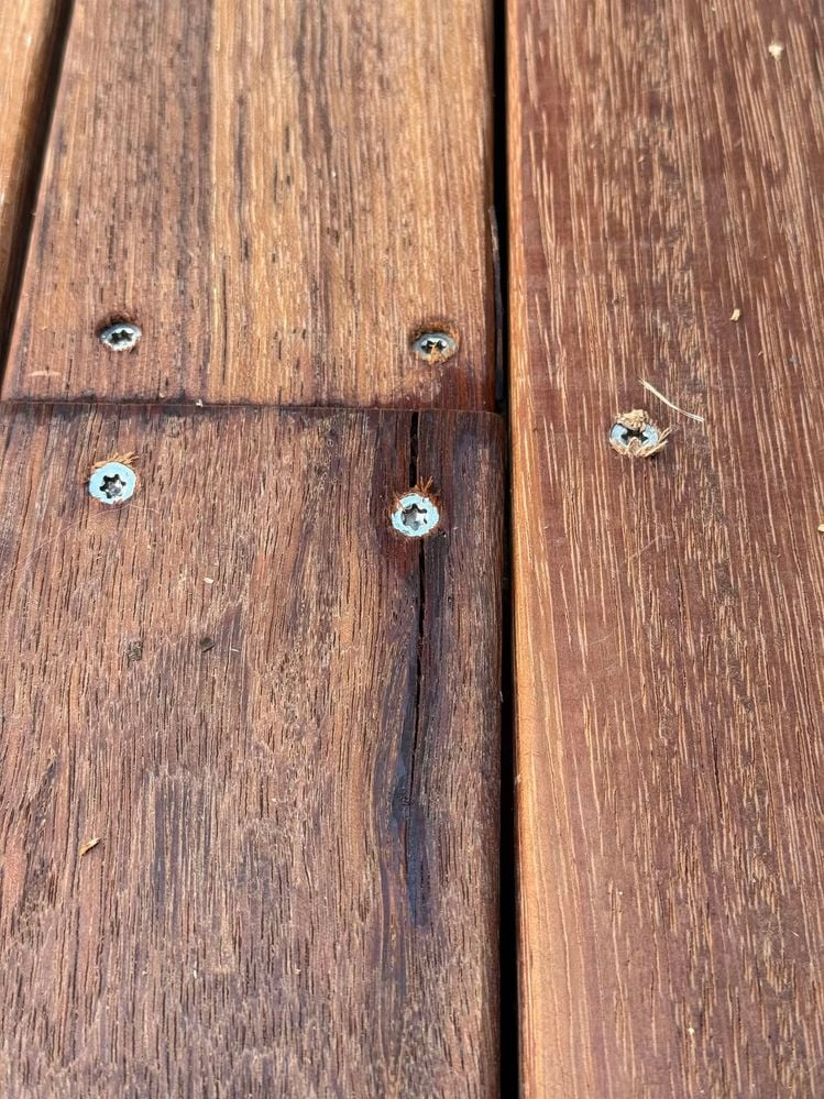

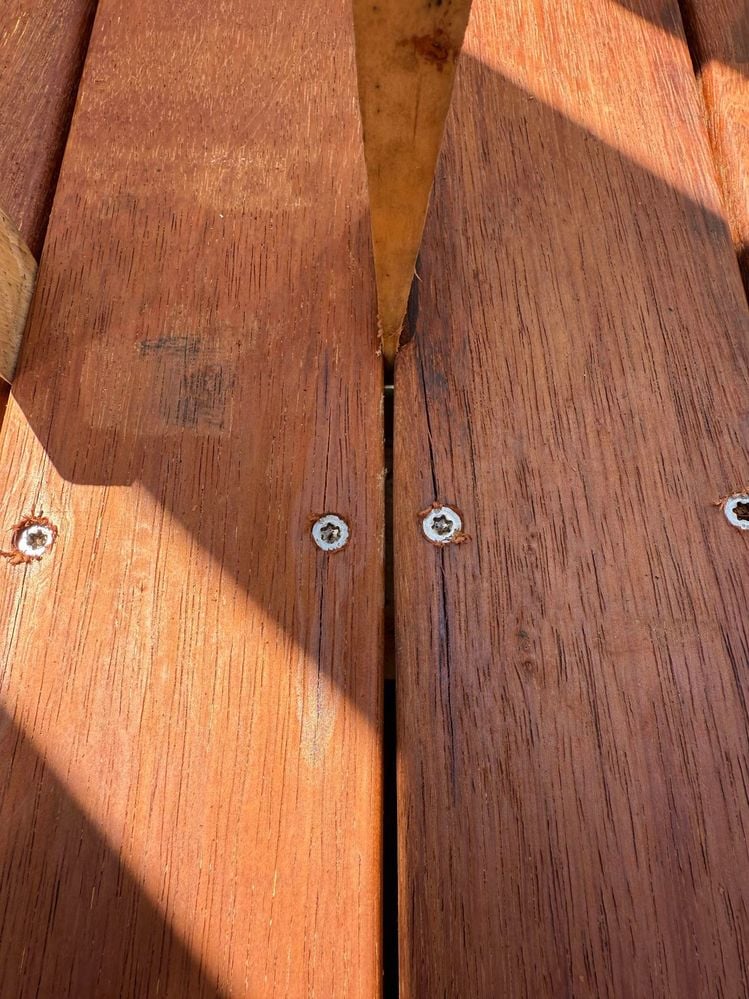

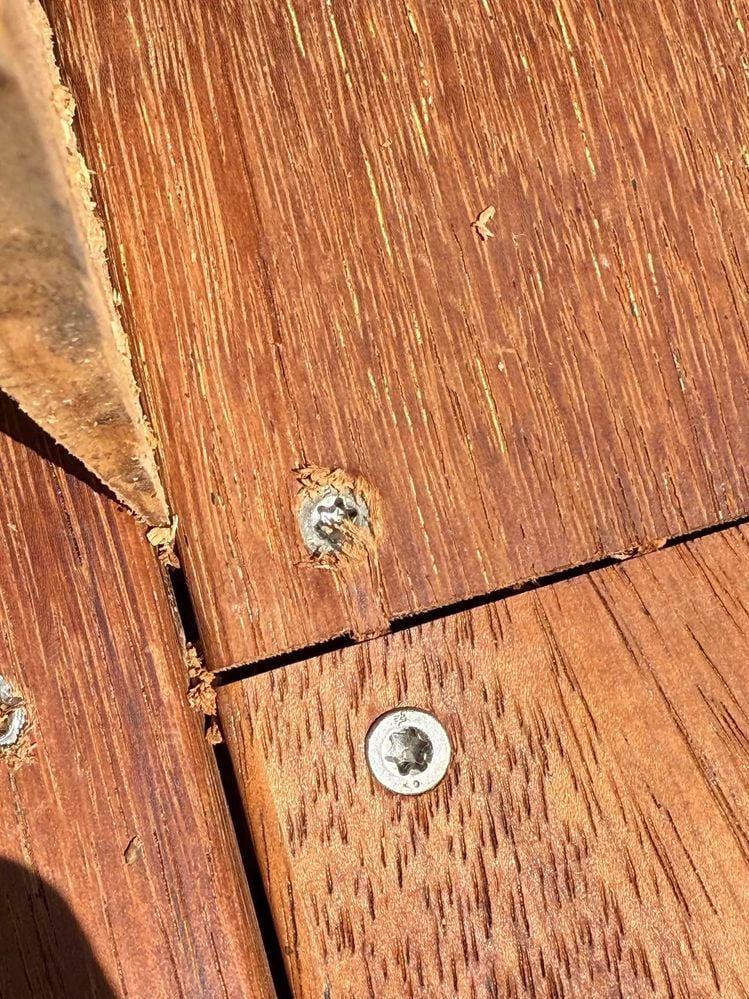

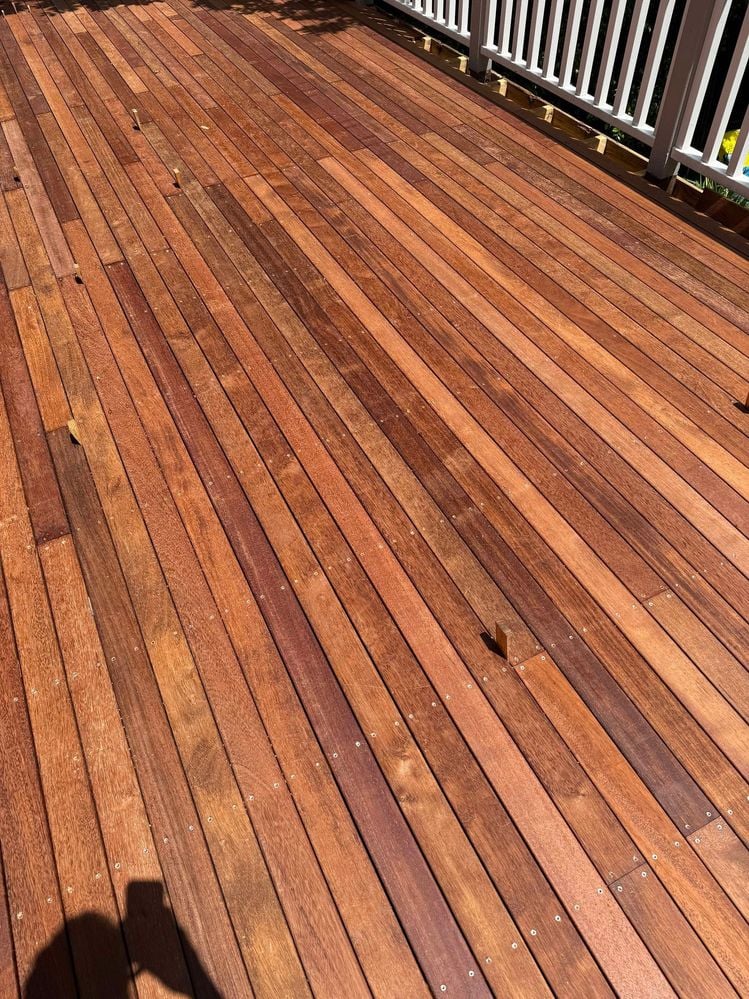

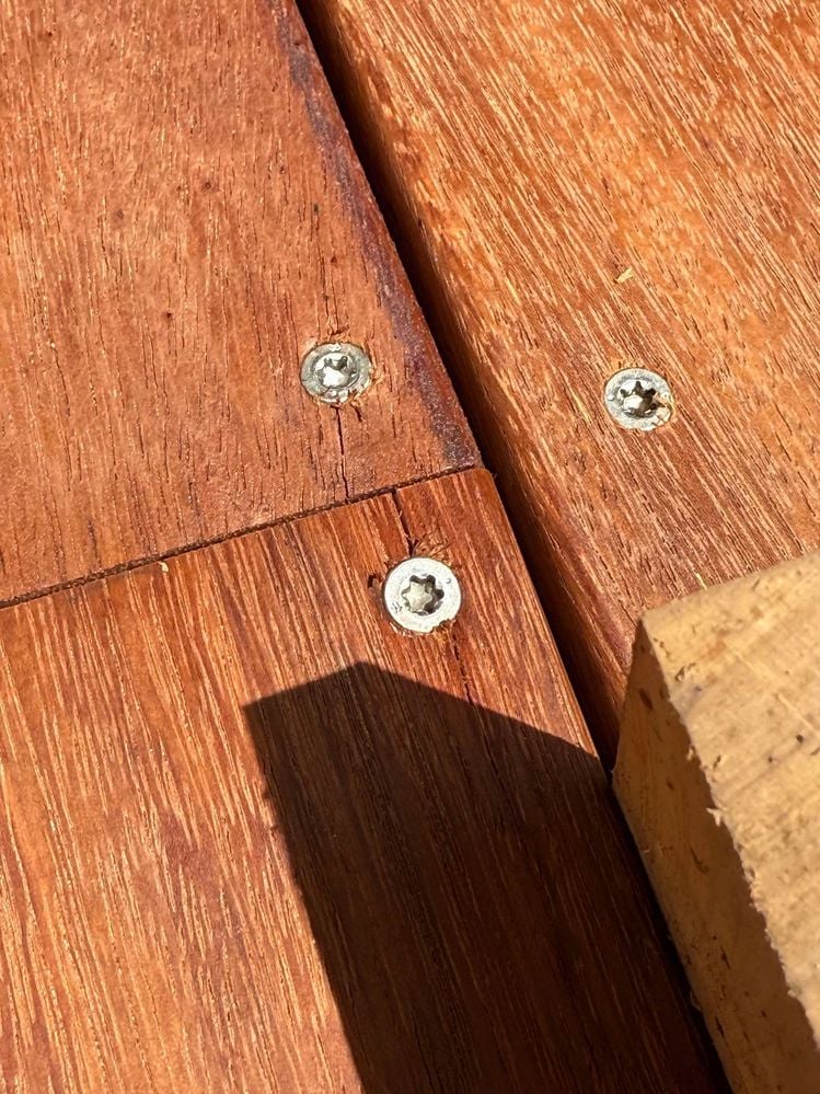

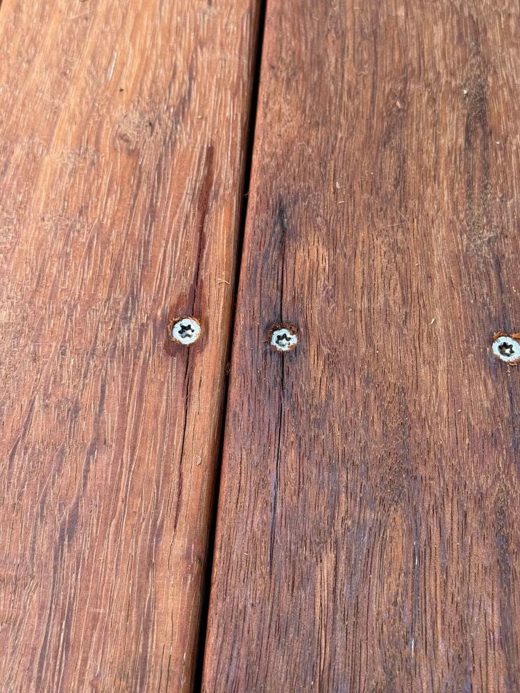

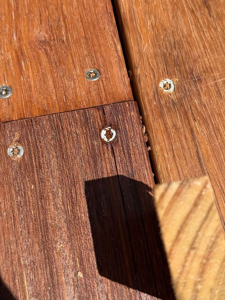

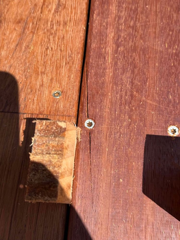

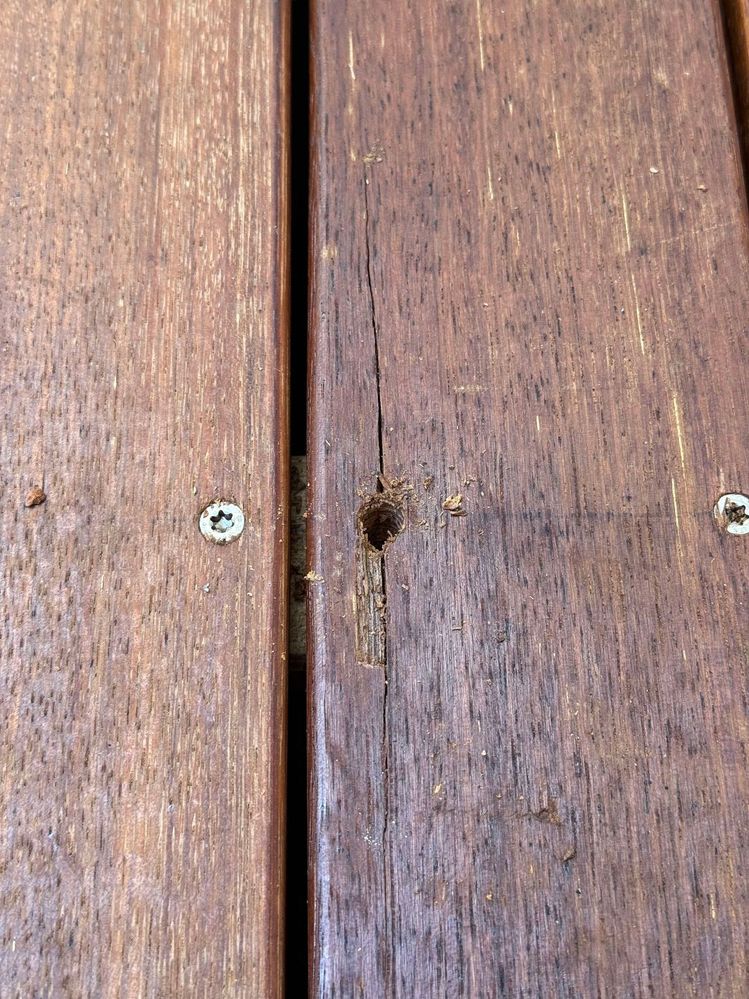

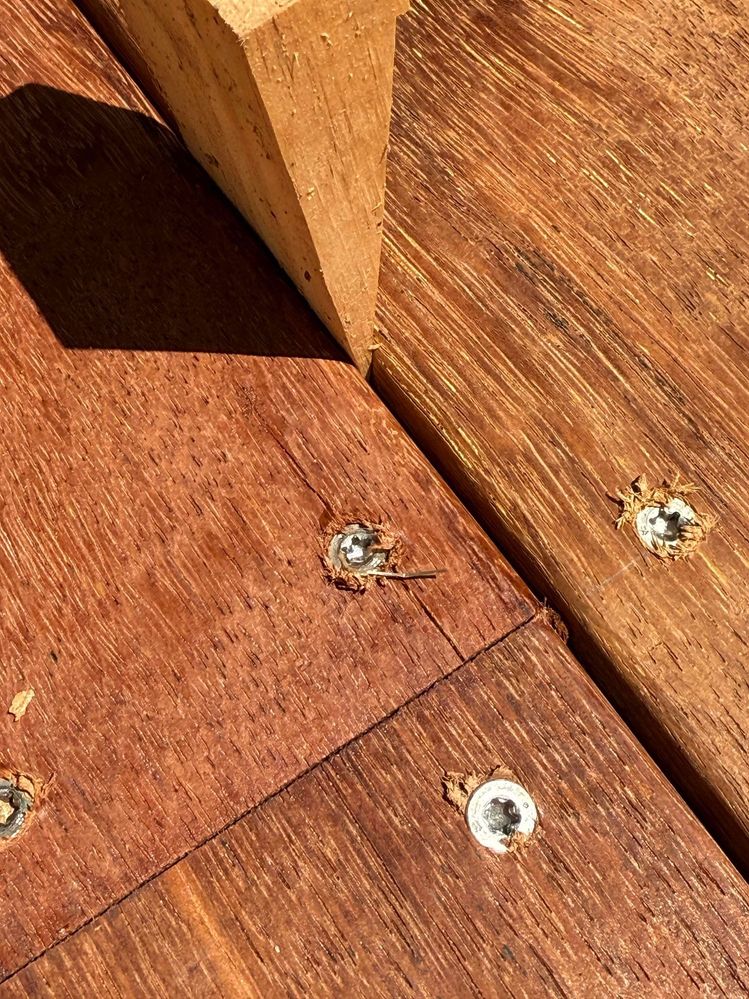

Hi Community,

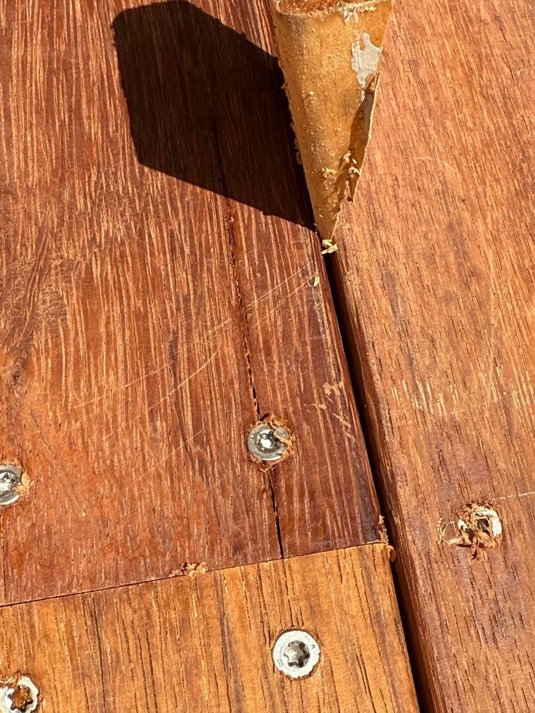

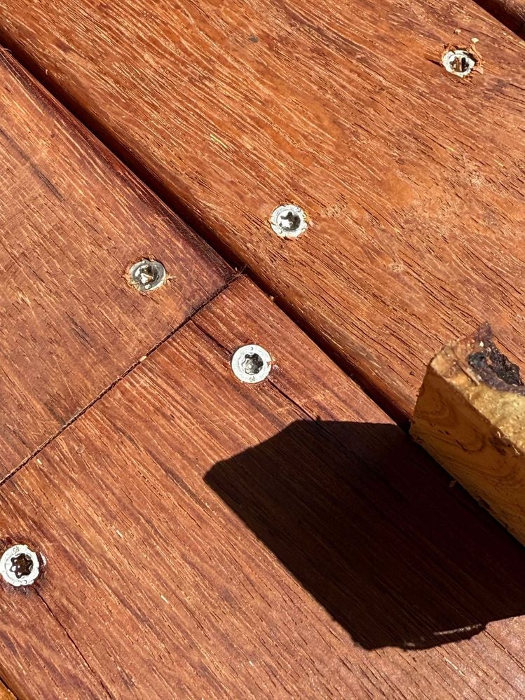

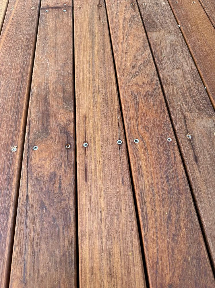

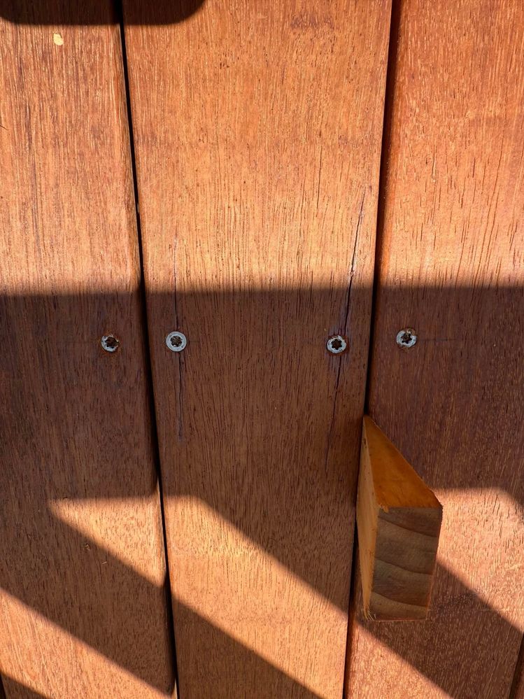

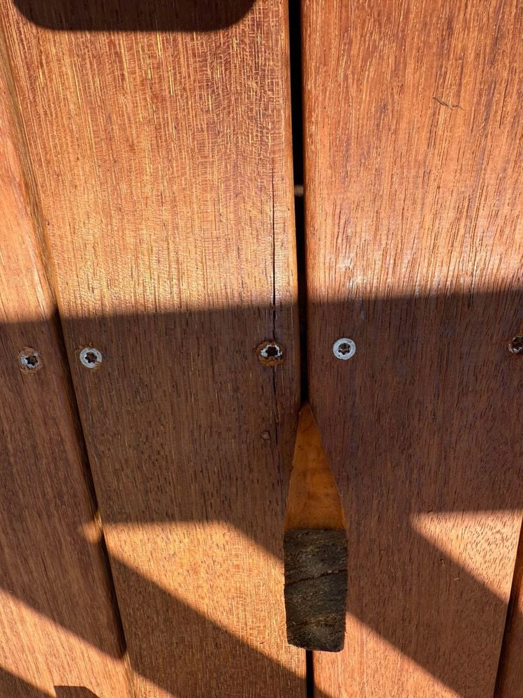

We've just had our deck redone and we've noticed a lot of cracks in the merbau where the screws are. Our carpenter has completed about 95% of the screws and there are about 100 cracked areas on our 60m2 deck. He's been using these screws, which do not require a pilot hole, as long as you're far enough away from the edge and ends of the boards, I believe:
  • Simpson Strong-Tie 12G (5.5mm) x 65mm 316 Stainless Steel DHSD No-PreDrill Hardwood To Softwood Decking Screws
He's advised us that he hasn't been drilling pilot holes when in the middle of the boards, but has been on the ends of the boards with a regular drill bit the same size as the screws, but not a countersinking drill bit.
The decking is pre-oiled 90x19mm merbau.
He will likely replace the worst of the boards, but with about 100 cracks, we won't be able to get everything.
Reaching out to see if there's anything we can do with the cracked boards that are left. Currently planning to wash, oil and maintain regularly, but also considering trying to seal cracks with Selleys Aquadhere PVA Wood Glue Exterior Adhesive, removing adjacent screws, wedging boards closed, re drilling screw holes and then screwing again. To try to seal up the cracks as much as possible.
Any advice would be greatly appreciated.
We understand that predrilling all screws with a countersinking drill bit 15-25mm from the edges and ends of the boards is best practice and how to avoid this happening, but the deck is almost finished now and we're looking for a solution moving forward.

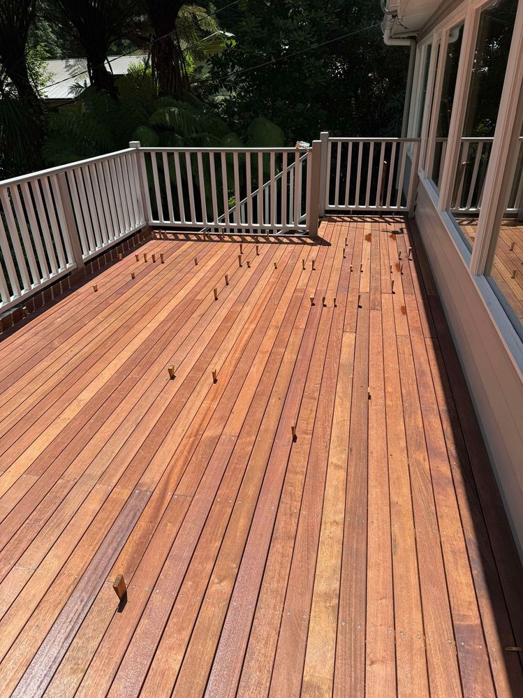

The wedges in the photos are marking some of the cracked areas.

Hi @David10 , wellcome to the community,
the result you have from the new deck is dissapointing , i have used the same screws in my deck with no problem (no pre drilling) but i did use Jarrah decking though.
some of the close ups the timber looks dry as if it has been sitting out in the weather for a while, do you know if it has?
I dont think there is no easy option but to ask for the damaged decking to be replaced as required.

Hi @David10
 To see this so widespread in Merbau is very unusual. My best guess is that the splits are a result of insufficiently sized pilot holes to suit the gauge of screws.
Unfortunately I don’t have a long term solution that I can offer other than putting it back on the installer to replace each effected board.

Thanks very much for your reply. Yes, we are a bit disappointed. From far the deck looks nice, but it's a bit of a mess up close, and the cracks may show more as it ages. The deck has been hosed off a few times already and lost quite a lot of tannin, so it doesn't seem like it was left out in the weather before being delivered. It was installed a few days after delivery.
We'll ask for some of the decking to be replaced, but not sure if we should ask them to replace all of the cracked lengths, as there are about 100 cracks in maybe 60 lengths. We're also concerned about drilling into the joists too many times, although they're 140x45 treated pine, so should be ok, just keen to reduce the chance of rot in the future as we live in a very wet part of Vic.

Morning @David10
The benefit of pilot holes as you may know is to both stop wood from splitting and provide a much more secure bond of the top material. As the bit is drilling each hole, wood is being removed which provides the relief of pressure from the fastening screw. When using those types of 2-in one deck screws the wood isn't being removed, so there will be outward pressure. This means it's even more critically important to place the screws 20mm - 25mm with 140mm boards and 17mm - 20mm with 90mm ones.  Your photos show that the screws are all very close to the edge making the boards easier to split. The other reason for additional pressure, is those screws are not providing a countersink for the head. So, more pressure is applied as the screw is driven home and leaves those very rough edges around the head.
Here is an example of way to close to the edge
Screenshot 2024-11-27 at 7.21.12 am.pngScreenshot 2024-11-27 at 7.22.02 am.png
I would recommend as @EricL has to repair the boards buy removing and repairing one board at a time. I would recommend using this high-strength wood glue by Gorilla and then clamp until the recommended curing time has expired. I would drill out each hole before re-laying. The same length screw should be fine if the joists are new. Otherwise you can get longer ones for greater peace of mind. Alternatively you can use pre-drilled and countersunk batten screws which I use.
