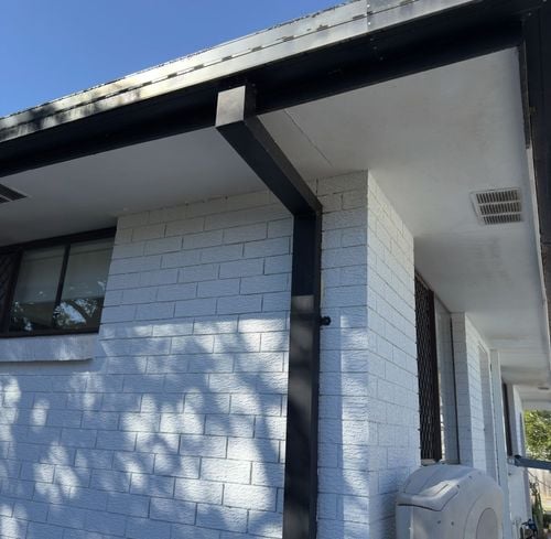

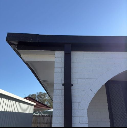

I’m planning on replacing my home’s downpipes and could use some advice.
The house was built around 1985 (QLD), and it currently has square downpipes. I’d like to swap them out for round PVC downpipes — partly for aesthetics, but mainly because the current system struggles with heavy rain.

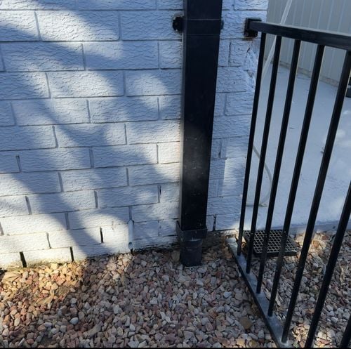

Swap out all the downpipes for 90mm PVC, leave a gap above stormwater with grill drains for easier maintenance, and hopefully get better flow.

You wouldn't be able to simply remove the rectangular downpipe pops and replace them with round ones, as the corners of the rectangle would remain open. In this situation, you should be able to use Holman 100 x 80 x 90mm PVC Stormwater Downpipe Adaptors to transition from the rectangular pops to the round pipe.
Running downpipes directly into stormwater is neat, but it hides blockages. Leaving a small gap with a grated drain (also called a "dry joint" or "inspection point") at ground level is a good practice. It lets you see if water is backing up, clear debris easily, and still connects to your stormwater. Since you don’t have gutter guards, this is what I would do.
Yes, 90° bends can cause dripping sounds, but considering you already have 90° bends in your downpipes, if they were going to annoy you, you would likely be aware of them already. I wouldn't really factor this into your decision-making. If it becomes a problem in future, there are options for addressing it.

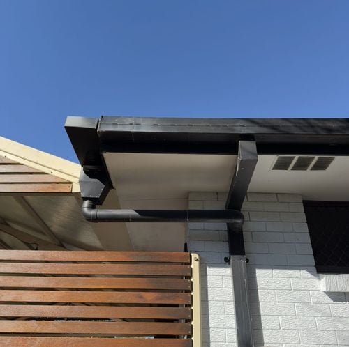

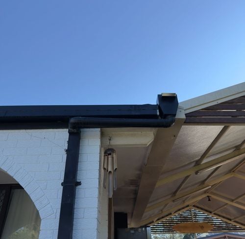

The water backing up into the eaves near your deck suggests the gutter and downpipe there are undersized for the roof catchment area. Even with the rainhead you can see in the first photograph, once the inflow exceeds capacity, water can spill back. I'd consider adding an additional downpipe in that section or upgrading to a larger gutter profile.

I switched my downpipes over to the air gap system as I have a large amount of leaves that fall, end up in my gutter and downpipes. I think it has helped me out with less blockages but also something to note is you will need a dogs leg kink to get the down pipe to exit over the grilled base squarely.

In regard to the water backing up... Where do you suggest I add another downpipe? Do you mean like a dual downpipe at one of the ends or in the middle of the gutter somewhere. Issue with the middle is that its enclosed and no room to install a downpipe unless I drill through the eave and then into the metal gutter. Additionally, could I replace the rain catcher with a larger one that's currently used?
Pictures attached of the gutter between house and deck area + raincatcher
What would you suggest i do with the front downpipes. Obviously, no room to install a 90 elbow, do you think it would look ok if i go straight down from the gutter and mount to wall or would you suggest I use a standoff mounting bracket that protrudes off the wall. I am in two minds...

Is the decked area the 21m side of the house?
A larger rainhead might help, but if it is not the choke point in the system, your focus might be better elsewhere. Have you noticed it overflowing when you have a large downpour?
At present, it looks like that gutter is servicing two separate roofs with two downpipes spaced, what I assume to be 21m apart. I just can't see it being able to handle a large downpour without adding a downpipe to the middle of that span.
Drilling through the eave to connect up an additional downpipe seems like it would be the most effective option on that side of the house.
For the front downpipes where you don't have space for a 90° bend, I'd just use two Holman 90mm 45° Elbows instead. You can always orient them slightly off square if there is not enough room.

Hi Jacob, no this side that runs with the deck is the shorter 12m apart. What raincatcher would you recommend as an upgrade that would connect to the stormwater.
i have not seen it overflow but i am only assuming its over flowing due to the metal grills rusted (connected underneath the eave) and water pooling below the eave. This only occurs when we have torrential rain though.

Rainheads are custom-made products that are outside my area of expertise.
You'd have to speak with a manufacturer for their advice on that one.
