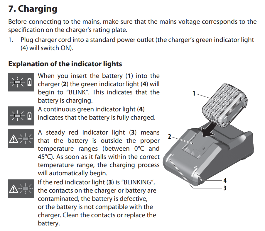

It wasn't the Wagner 18V W250 by chance? The Wagner W100 Wood And Metal Paint Sprayer is a plug-in 240V version with a cord. If it is the W250, then you would charge the battery until you get a solid green light on the charger. Charging times will vary depending on how much the battery was depleted.

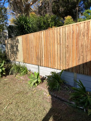

Whatever you choose to do, I am sure your fence will come up wonderfully, so please upload some photos when you are done, as it would be fantastic to see the result.
