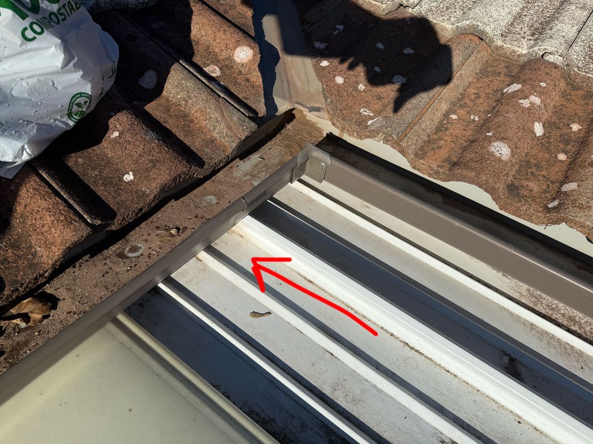

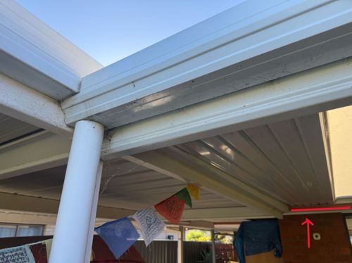

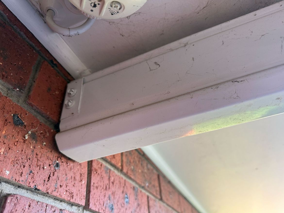

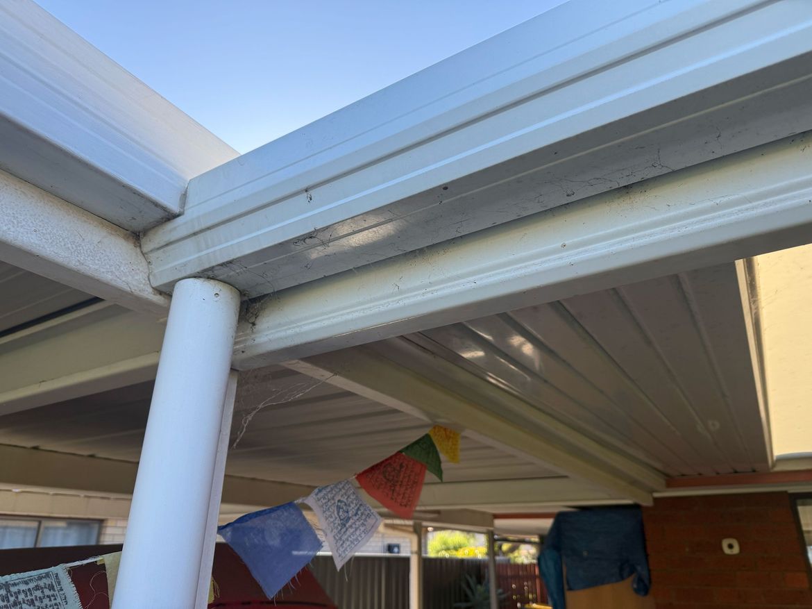

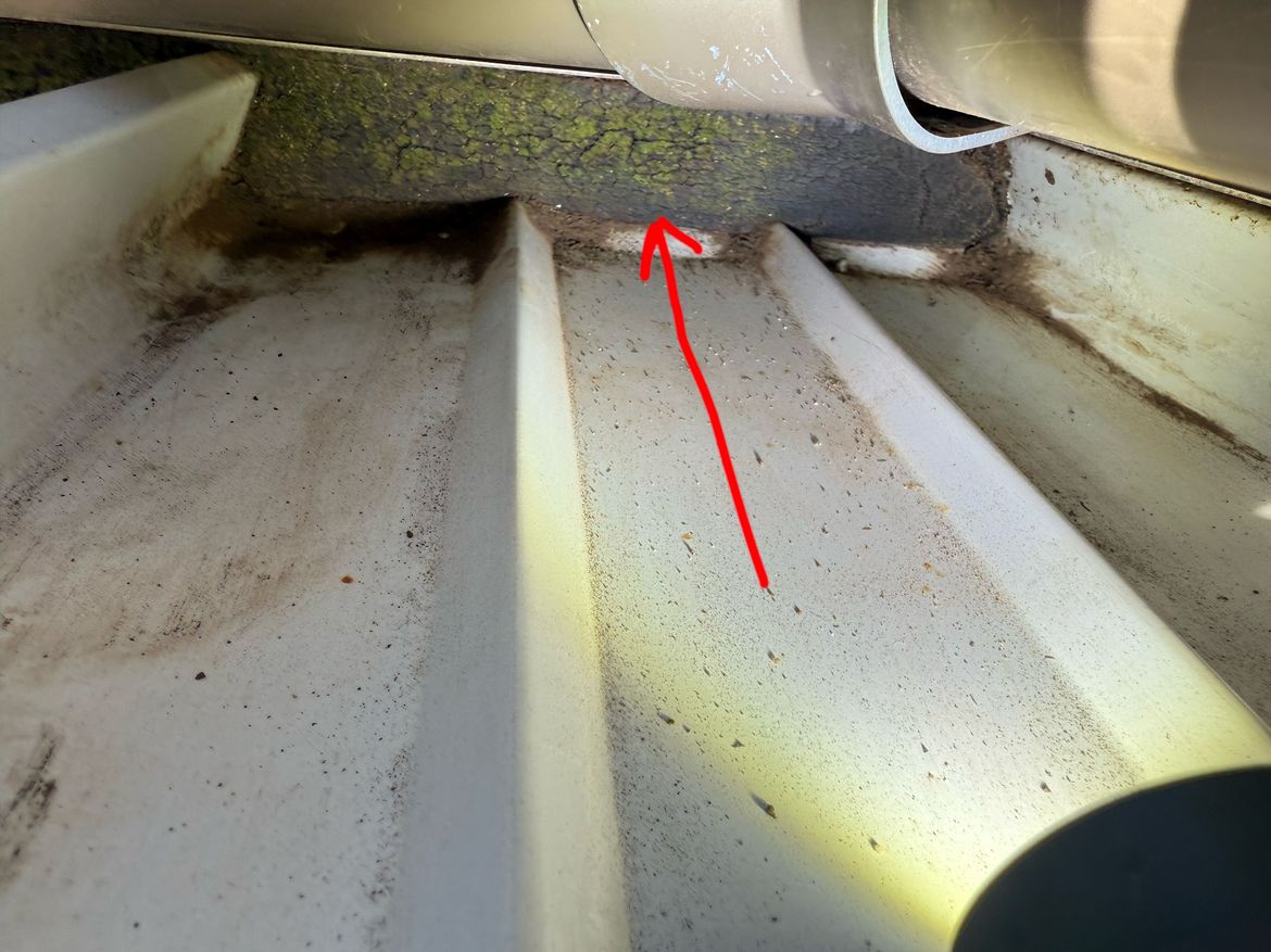

Hi folks, I understand if this might be beyond me and require a roofer, but taking a punt because you have been so helpful in the past. My back 'verandah' butts up against the house and sits directly under the gutter. The house has shifted a bit, and now the water sits up against the house instead of running the OTHER way to the gutter. So the water goes in the direction of the red arrow and pools up there, and then gets in/above/around whatever sort of join is there and then leaks down into the back patio through the wood which is now starting to rot a little.
There's not really room to lift anything up to change the pitch of those sheets easily without almost completely re-doing it so wondering if there's a short term fix to just... ah... waterproof it in that area so it holds water but doesn't leak through? It looks like there's just foam insert there which obviously wouldn't be waterproof... I know it wouldn't be a proper fix and having water sit there might not be ideal, but could i maybe paint the area with something like Crommelin waterproofer and hope for the best?
Or do i just admit defeat and get a roofer in...? I have tried to get a few people around to quote but the first quote was $10,000 and the second company never even came back to me... i suspect the best approach is to tear it all down and start again, but wouldn't mind a short term fix if anyone has any suggestions.
Sidenote: Access into/under there isn't great either and those sheets won't support my weight so even getting to it is a bit tricky.
