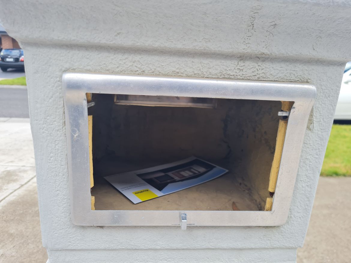

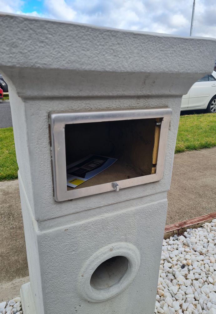

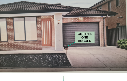

G’day,
We’ve just realised that the access door on our letterbox was missing at the time we purchased our home – something we unfortunately overlooked during the inspection (not helped by the less-than-professional seller, either).
I’m wondering if there’s a way to repair or replace just the access door without having to buy an entirely new letterbox, as the rest of it is still in good condition.
Letterbox is most likely of this type: https://www.bunnings.com.au/northcote-pottery-35-x-90cm-grey-metro-pillar-letterbox_p0018447
Would really appreciate any ideas, suggestions or advice you might have!
Thanks in advance – keen to hear your thoughts.

"(not helped by the less-than-professional seller, either)
I hope it's not the same seller that put the visible flyer in your box?

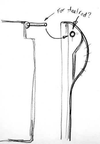

To my aging eyes there appears to be a 'bulge' at the top, that may have a tubular receptacle for a metal pin which I suspect was on the missing flap?
Is there any chance of photographing, very close in this area to see?
Can the remaining back frame be easily removed?
Just random thoughts for maybe a repair/replacement job made from steel plate.
But I think the above members ideas would be a better way to go.
Keep us informed.
Cheers.

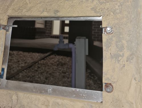

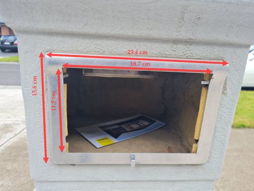

Hi Nailbag,
Really appreciate your advice. I’ve taken some approximate measurements (not 100% accurate), and the Sandleford product you linked seems to be a close match. The million-dollar question (for a $50 product): I couldn’t quite determine is whether the frame can be removed. I’ve attached a photo I took from the inside, it looks like it’s bolted, so perhaps there’s a chance it can be unscrewed?
Re: Letterbox access gate fix
Hi Noyade,
Haha ! good one on leaflet see the image at the end
Thanks a lot for suggestions. Here is the image from inside. the dimensions I believe are almost identical to Sandleford product that nailbag shared.
Hi @tailchopper,
It certainly looks like you can remove the old letterbox plate by rotating off the old bolts.
