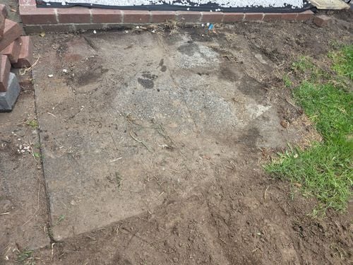

Hi, I would like to even out this area to that higher up brick line. Ideally to put pavers on top once done. The depth is 190mm at the front part I came across the bunnings video on 'how to lay a base for pavers'.
Would putting road base to even out the area and then paver sand work for this or should I use something else underneath first that would be better/more helpful for drainage? Also open to suggestions on a border temporary or permanent.

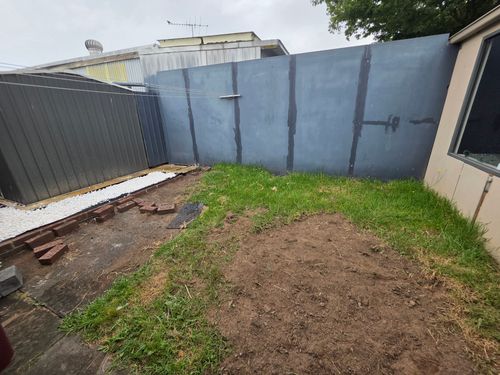

Please ignore the terrible blue wall and white stones(need to buy more). Future works in progress once this is done. Thanks!
