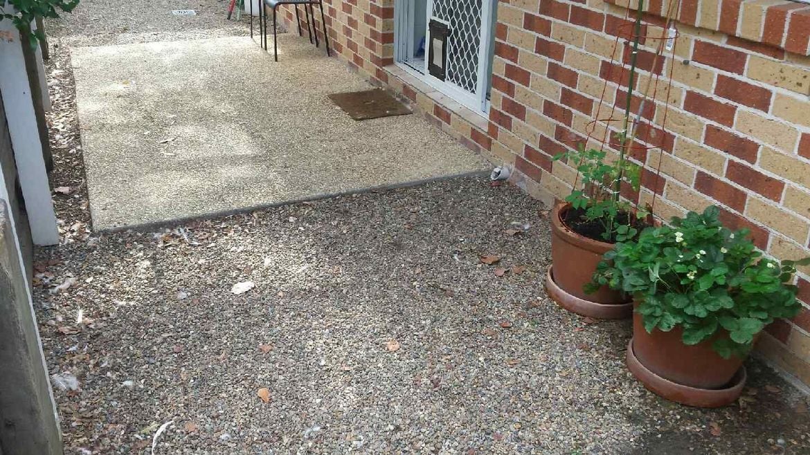

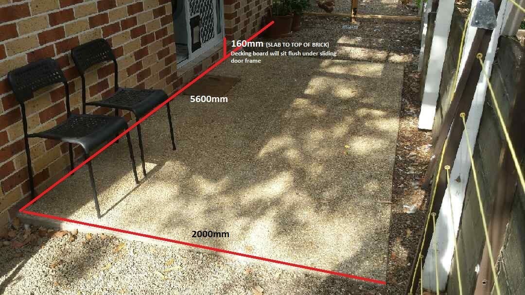

I am wanting to deck the side area of the house as pictured, it is a low step 160mm, but the decking board will sit under the slider frame (replacing the tiles) so there is about 20mm additional height, will easily accommodate a 140 x 45mm ledger board (if that is what I go with).
@Neo19 used L Brackets for joist support (which would work great on the slab) but will not work over the shingled section of the area, would have to go with posts I guess or a combination.
Really, my main concern is securing a ledger board to the brickwork, it seems the logical solution to span that 5600mm edge along the house.
Points of concern:
The necessity of spacing of the board to brick
https://www.workshop.com.au/t5/Outdoor/Decking-frame-ledger-spacing/td-p/33669
Termites etc, never had them on the property, we have existing "bridges" attached to the house.
Hardware: Ankascrews or Dynabolts??
I would prefer a flush finish on the board (Can countersink if necessary)
The design below is almost exactly what I want to do
Except I would construct 4 individual frames
So i have some decisions to make, any suggestions would be appreciated.
Thanks for reading and taking the time everyone.
Cheers

140x45 ledger attached to brickwork. Make sure your anchors are galvanised and remember the spacing. They don't need to finish flush/countersink as they'll be covered by the decking boards. What's your concern about the necessity of the spacing?
You shouldn't have to worry about termites as H3 treated pine (ledgers/joists) are treated for termites.
