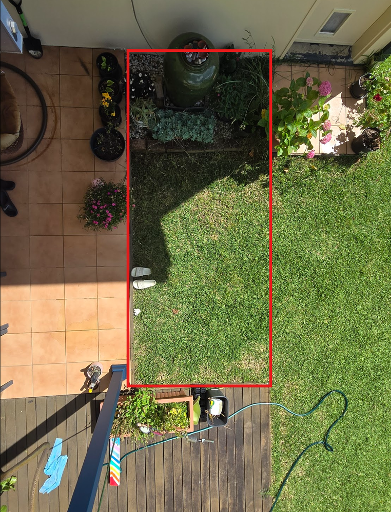

I want to extend the deck (Dimensions to 3480mm * 1440mm). Reason: In winter the grass is completely dead & utilise the space. Image of extension:
Deck Extension

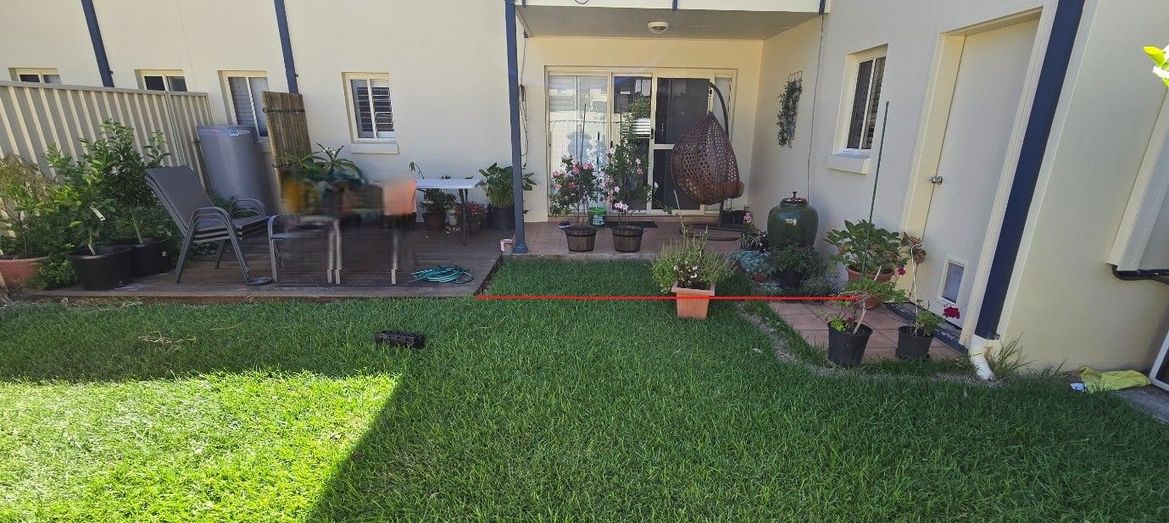

The aerial view of the existing deck
Aerial View: Existing Deck
Side view of the existing deck and proposed extension

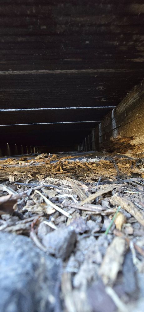

The plan was to fix a few boards on the existing deck; however, upon inspecting, the "bearer" & "joists - all" are rotten.
Below are the examples:
Joists
UnderDeck
So, the extension soon changed to a complete re-do of the deck.

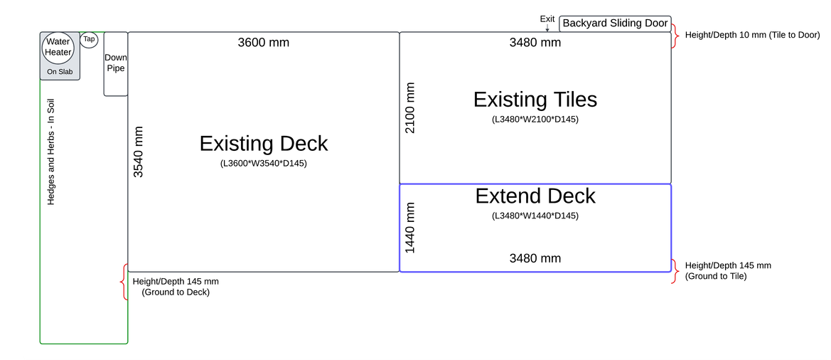

Here is the plan:
Plan
Considering the height until the tiled area is 145mm, even if I go up to the sliding door covering the tiles with the deck, it will be 155mm. Further, on the left of the existing deck, in order - I have a downpipe, garden tap, water heater and plants in the soil.
Would the deck still be a good option, or am I better off concreting the area and doing other landscaping?
Thank you again for reading the post, and looking forward to the replies.

I agree with @Jewelleryrescue that concrete slabs with tiling are likely the best option for your space. The rotting of the original deck joists is a clear indication that the low clearance height contributed to moisture retention and decay. H3-treated joists are designed for above-ground use and, unfortunately, aren’t suitable for direct ground contact, which has likely exacerbated the issue.
