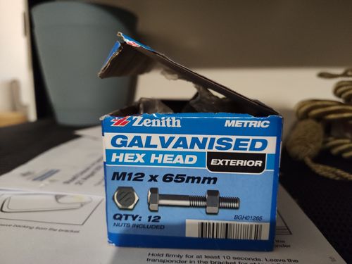

Hi @Nathan88 Thank you for your kind words!
I have kept joists at a maximum of 450 mm intervals. I said maximum as due to the length of the deck it was impossible to have all spaced exactly the same.
Joists were 3500 long and I have used 4 brackets per joists.
Bracket type that I have used was this
Still have some bolts left from the job.
See below
All the best with your deck!
