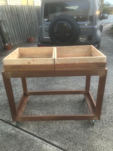

I haven't had a vegie/herb garden for a long time. I just missed having having fresh herbs and vegies.

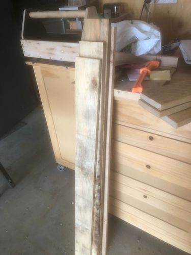

 had some pallet timber that were in my shed, I got these from a pallet manufacturer, in my area about two to three years ago, they were very fresh and wet, then, now they have completely dried out and good to use for my project.
Trolley size, 110cm long x 54cm wide x 90cm overall height
Materials
Pallet timber  (free) for the planting boxes.
Merbau timber 70mm x 19mm, (pre oiled).
4 Castor wheels - 2 Braked and 2 Non braked.
Screws for mounting wheels
Wood Glue (Wellbond) for the pallet timber.
Polyurethane glue for the pre oiled merbau.
Screws for assembly.
Weedmat material for inside of boxes to protect the wooden boxes
Fixing clips for weed mat.
Tools

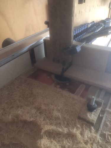

Router table for cutting box joints on pallet timber
Router for biscuit joining merbau timber.
Drill for assembly.
Mitre saw.
Various clamps.
Steps
Step 1

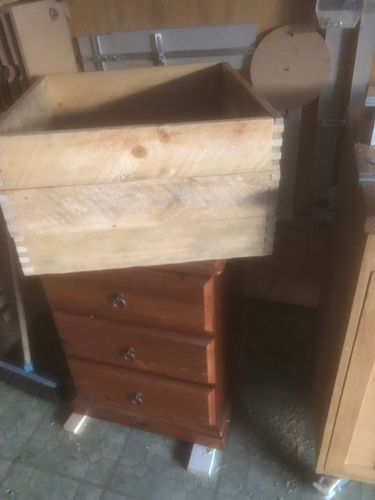

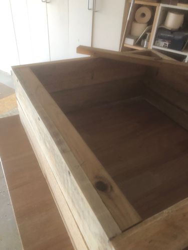

Pallet box size,520mm x 540mm x 200mm

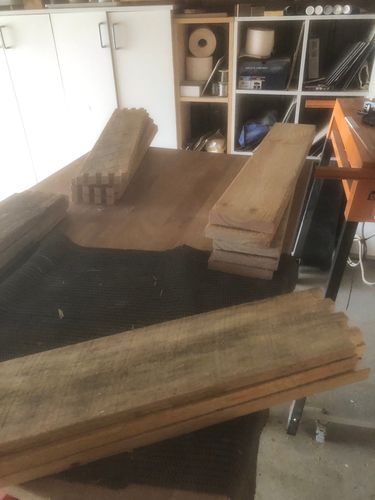

Cut pallet wood to suit boxes.

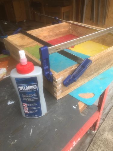

Using router table, cut out the box joints.
Step 2

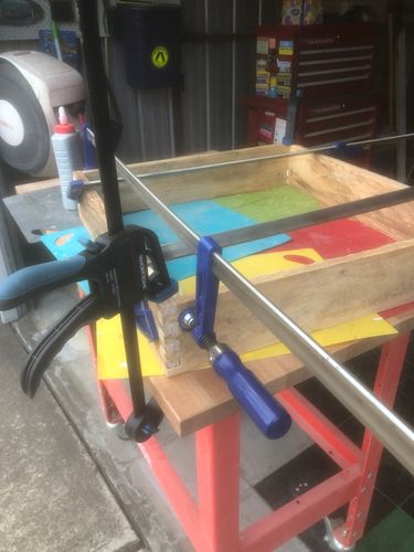

Glue and clamp boxes.
Step 3

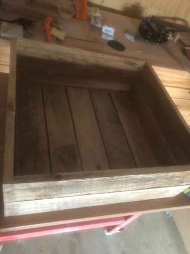

Cut to size the base timber for each box, leaving gaps for drainage.
Step 4

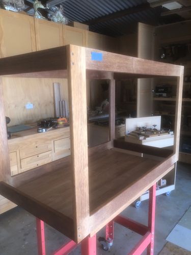

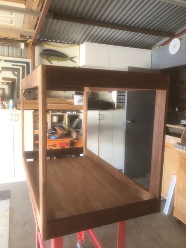

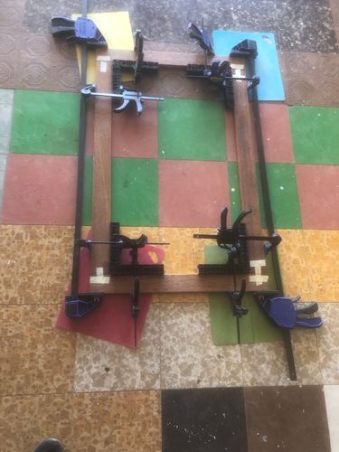

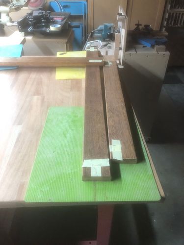

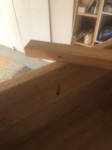

Cut the merbau timber for the trolley

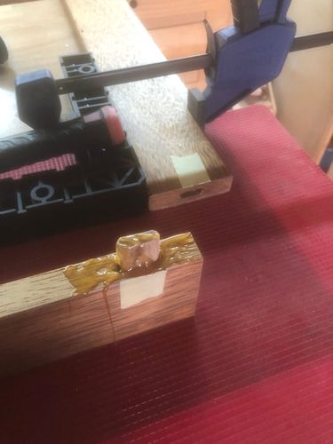

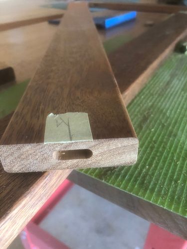

Cut out biscuit joints.
Clamp all timber using polyurethane glue, I found that the wood glue wasn't suitable due to the pre oiled timber.
JoeAzza_10-1687161993270.jpegJoeAzza_11-1687162014496.jpegJoeAzza_12-1687162053882.jpegJoeAzza_13-1687162071383.jpegJoeAzza_14-1687162104526.jpegJoeAzza_15-1687162131544.jpeg
Step 5
Install castors.
Step 6

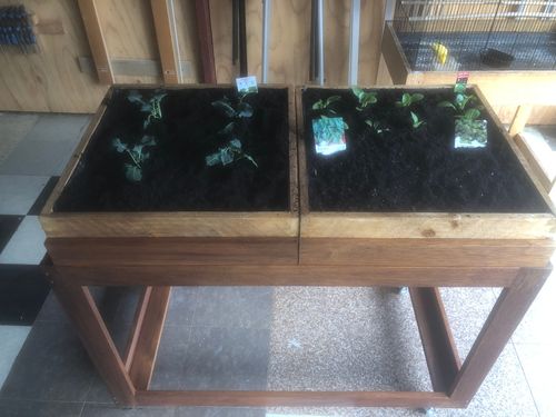

Cut and fit weed mat into boxes.
Paint trolley and and boxes with decking oil.
Fill planters with potting mixture.
Plant seedlings and seeds, then wait for the magic to happen and follow the sun.

You've definitely got the diy bug @JoeAzza!!  That's a beautiful piece of work.  Its given me some ideas for my planting plans come spring.  Are you going to utilise the bottom shelf for shallow rooted plants as well?   And please tell me the need for weed matting in a planter box?

@Tyro , That’s what happens when you retire, keeping busy😀.
I used the weed mat, to protect the inside of the pallet wood, hopefully the timber won’t deteriorate too quickly.

Well I've got to say @JoeAzza that I hadn't thought of that at all!  May I ask how come you went with that choice rather than builder's plastic?

Hi @Tyro I had some weed mat left from another planter box project, installed approximately 3 years ago, so far no problem, not sure how long it will last.

Hi again @JoeAzza!  I haven't explored using biscuit joints, but your use of them has triggered my curiosity.  It looks like a specialised tool is necessary, is that right?  And what benefit are biscuit joints over dowel pegs?
Thanks!  🤗
JoeAzza
Amassing an Audience
Re: Mobile herb and vegie trolley using pallets

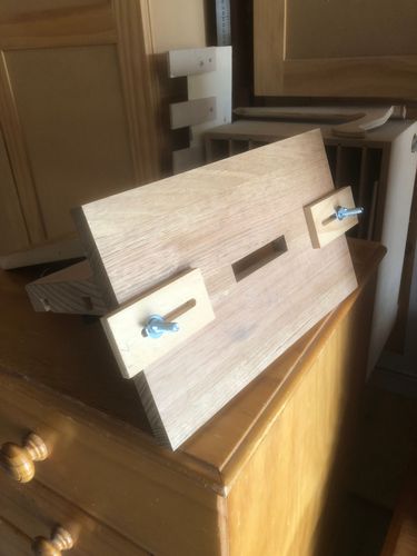

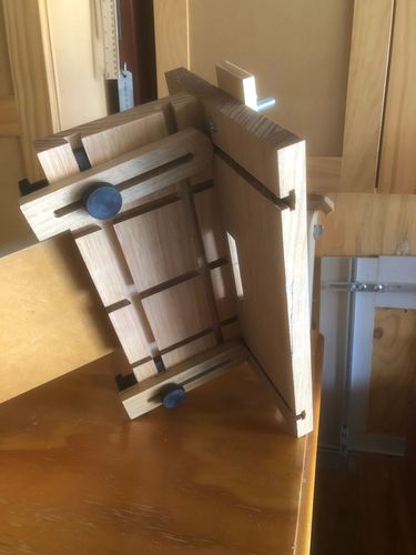

@Tyro  I use a Ryobi biscuit joiner to align pieces of timber whilst gluing them, I do welling in a bit stronger, however, I think the glue is doing most of the work,
You could use a small trimmer/router and a jig to make your own slots for biscuit joining. I made one, copied from YouTube.
