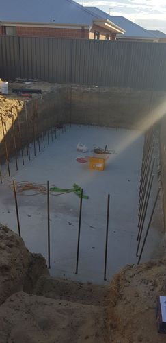

It's been a crazy week getting my chemical grout injection (CGI) done, hole dug, base formed and poured in situ, precast panels made and installed.
And this week it's all about getting the concrete poured around the pool, the glass fence in and the surrounding fake grass. The pool area itself will consist of concrete and decking as we push for different textures and dimensions, keeping things as raw as possible.

A couple more pics with the surrounding concrete done, glass fencing and the amazing black spigots and hardware, and the grass. Next is to finish the inside of the pool with steps, platform and ledge, then do the feature fences (exposed bricks, timber -- still a little undecided), followed by the decking on the sides where you still see sand. And of course installing the pool equipment.
