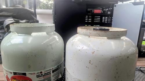

Re: New Matador Ignite+ 4 burner Barbecue experience
@JacobZ
OK, not all gas cylinders are created equal.
So my replacement gas cylinder has a smaller "skirt" than the previous one. This results in the Gas level being squeezed by the stand that the cylinder stands on. My guess is this isn't healthy.
Old one on left, replacement on right. I tested the old one, and yes, there is a significant gap between the bottom of the cylinder and the bottom of the skirt, so the level indicator isn't squashed.

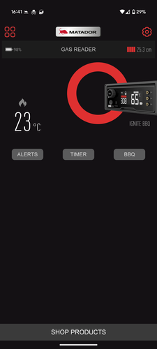

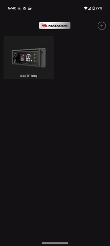

Here's the setup, there is no instruction manual.
on my smartphone:
Open the Matador app:
Open the Ignite BBQ:

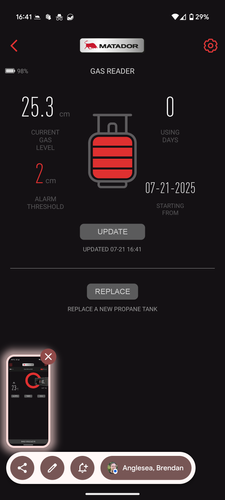

Screenshot_20250721-164106.png. Then select  "Gas Reader" Screenshot_20250721-164110.png

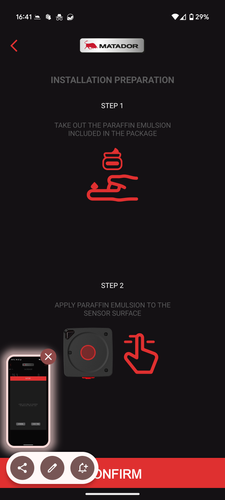

So you should do either update or replace. Replace:

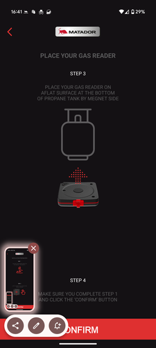

Screenshot_20250721-164130.png. Confirm: Screenshot_20250721-164135.png This takes you through the steps for positioning:

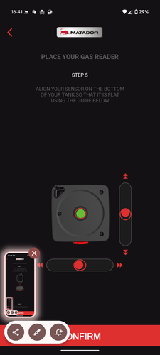

Screenshot_20250721-164140.png. then there's a "Bubble meter" Screenshot_20250721-164146.png Baby steps to get ir right. I was able to do it by having the cylinder upside down and not connected.
Screenshot_20250721-164152.png Make sure you have the right sizes etc.
Then put the gas cylinder back in place, connect it, and "Update"
That may help some people. I'm still getting a replacement, $38.00 so not a big expense.

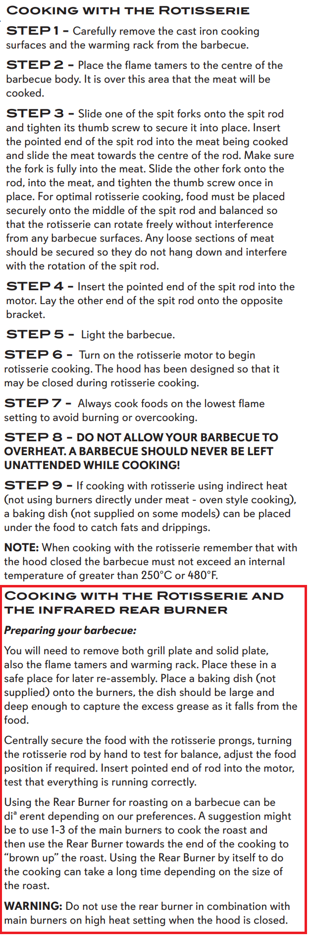

Just seen your comments about the bbq not having an adjustable rotisserie, my rotisserie is pointless unless I can adjust it, tried it on full but it’s just too much heat for an even cook of meats,
can this be replaced with an adjustable one?
Re: New Matador Ignite+ 4 burner Barbecue experiance
Welcome to the Bunnings Workshop community @omahonyplant. It's terrific to have you join us, and many thanks for your question about Matador BBQ's.
I do apologise, but there appears to be some confusion in this discussion.
The BBQ is not designed to use the rear burner solely for cooking when using a rotisserie. It is used at the end of the cooking process to "brown up" the roast. For cooking the roast, the rear burner should be off and the plates adjusted to cook with the lower burners. I've attached an excerpt from the instructions below.
Bunnyman
If you read the manual you will notice that it states the rotisserie only has one temperature which is max. Use it towards the end of your cooking just to brown
