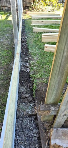

  • We discovered the adjoining fence (not being replaced) was so unstable it could collapse, so we tied its rotting post to our concrete pillar with rope to keep it upright.
  • While setting out the line, we discovered the boundary was wrong. What should have been a straight line was crooked, and lazily patched together when these houses were built. After checking our property plan, we found the neighbour had lost land, and we had lost land to the neighbour in front of them. We decided to correct this to the proper boundary, restoring about 500 mm of land to our neighbour. We would gain land back from the next neigbour during the next build, and would ensure a straight line down our property.
  • Holes were dug for the new posts, cutting through a lot of clay and even bedrock in places.

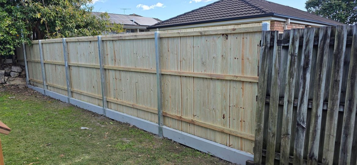

Day 3 – Completing the Fence
  • Timber panels, rails, and palings were installed above the sleepers.
  • The fence was built in a stepped configuration to follow the natural slope of the land, ensuring a neat and even look.

The transformation is striking. Where the old fence leaned, sagged, and left gaps wide enough to see straight through, the new fence stands tall, solid, and precise along the true boundary line. The fresh timber panels, supported by galvanised steel posts and anchored by concrete sleepers, give the yard an immediate lift in appearance.
From our side, the finish is clean and uniform, with the warm tones of the timber complementing the natural surroundings. The stepped configuration means the fence follows the land’s contours rather than cutting across them awkwardly, which adds to its polished look. Every sleeper is set perfectly level, and the posts are dead straight – small details, but they make a big difference when you’re looking along the full 10.5 metres.
The structure itself feels unshakeable. The combination of concrete-filled H-posts, heavy-duty sleepers, and tightly secured palings means there’s no movement when you lean or push against it. You can tell straight away that this is a fence built to outlast decades of weather and wear. Privacy has gone from almost non-existent to absolute; you can now relax in the yard without the sense of being overlooked. It’s also pet and child-friendly, with no gaps to squeeze through or weak panels to knock over. I'll paint it in the future once the wood settles.

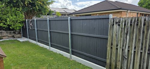

In between the summer storms I finally had a stretch of dry weather where the timber was dry enough to paint without the rain washing it straight off. I used Dulux Weathershield ready to go in Monument grey and got stuck into painting the fence posts. I just used basic fence brushes because I wanted to keep as much paint off the sleepers and posts as possible, covering them while I worked. It has already made a huge difference to the overall look of the backyard and I cannot wait to get the rest of the fence built to really modernise the space.

Hi @Remarka6le,
It really is incredible how a couple of coats of paint can change the look of a space and bring a more finished feel.
Thank you for sharing the update. I look forward to seeing the space when you've had time to finish the rest of the fence.
