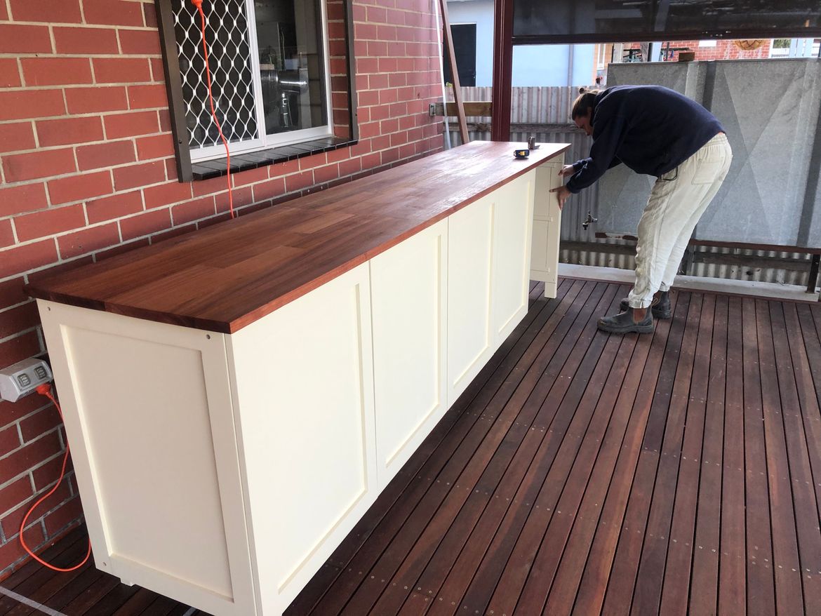

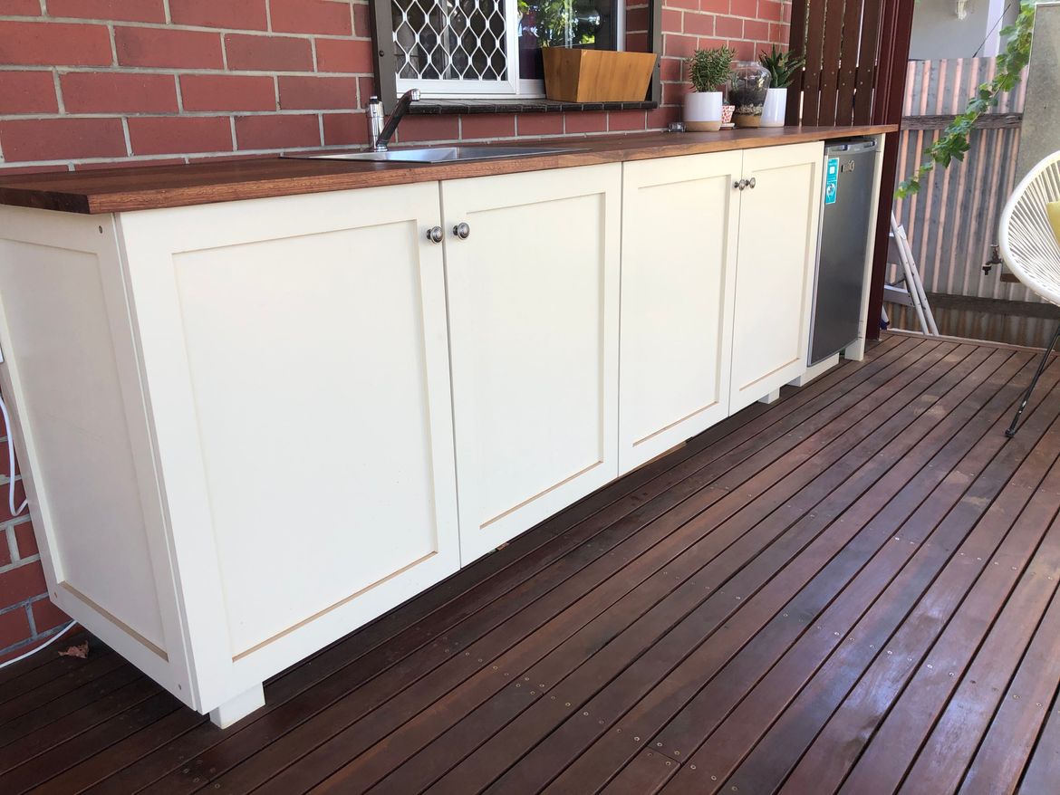

Every outdoor entertaining area needs a kitchenette.
This design is all Sarah's!

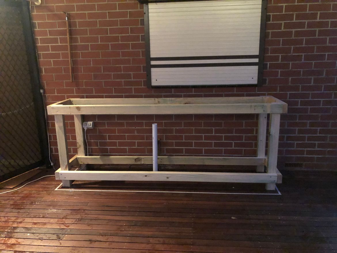

We've used treated pine to build the frame so it lasts better in case it gets wet from prevailing weather or when we are washing down the deck etc.
The bench top is 1.5 Interbuild Project Panels.

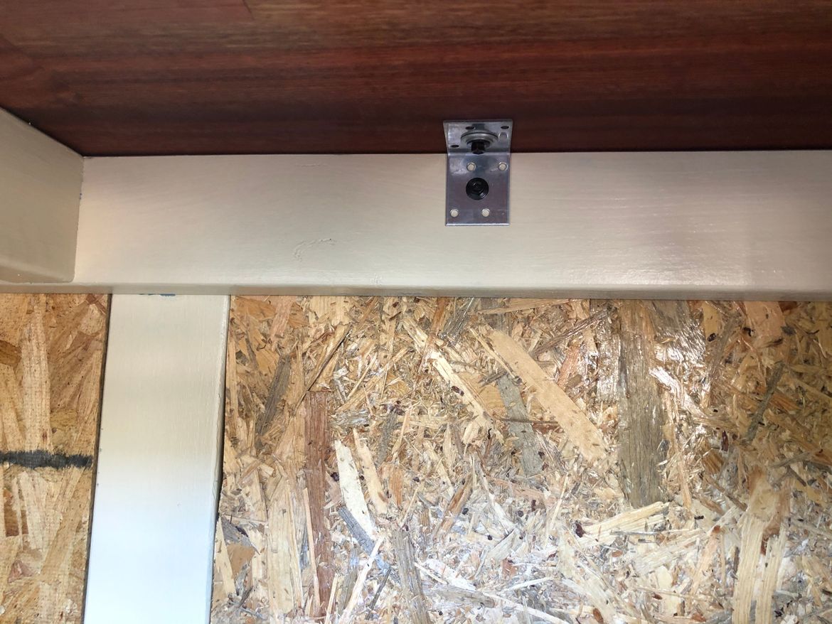

Cupboard is backed with OSB board, it's quite cost effective and water resistant.

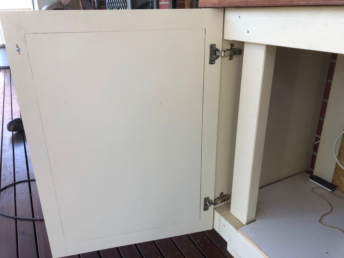

Panels and doors made out of Tasmanian Oak and Marine Ply.
All hardware purchased from Bunnings.
That looks incredible, @DIYgals. I love that you've scratch-made this entire unit; I am envious of your skills, especially with the doors. I'm not sure I would be confident enough to build my own doors, and likely have resorted to some pre-fab ones. The bench panels also complement your decking very well.
Congratulations on a spectacular job. I look forward to seeing your next project.
Looks great - well done!
