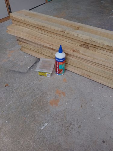

Fence palings. I used 1500 x 250 x 19.
Exterior wood glue.

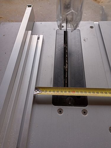

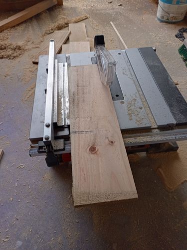

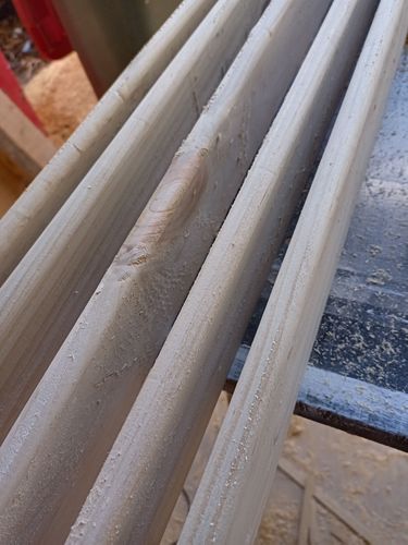

Entirely optional for a starter but I find it useful to run the palings through the table saw to take both edges off as these can be a bit rough. Evening things up at the start can save a lot of sanding later..

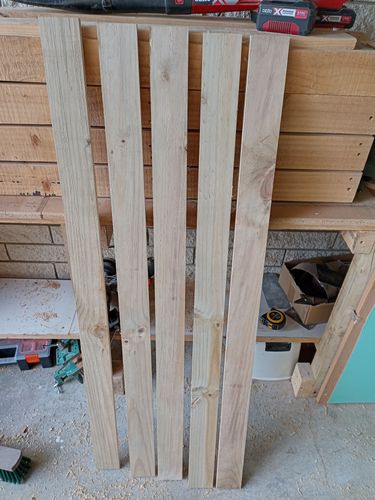

Cut the 5 top rails. I made these 80mm wide. I also trimmed the rough ends. They finished up being 1300 long..

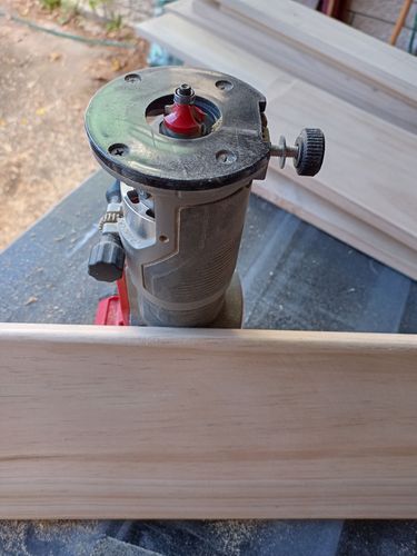

It you have a router you can chamfer or round the edges.

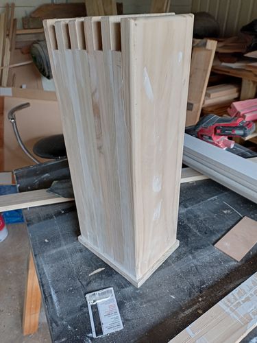

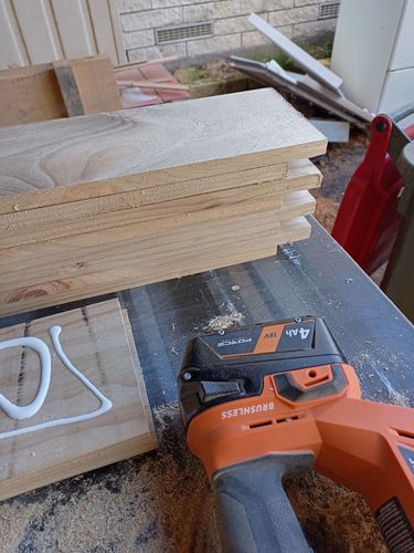

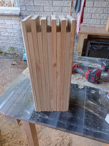

For each leg take 5 of the shorter boards and 6 of the longer ones.. Build stacks of boards alternating short and long. Add a generous bead of glue between the boards and screw (I may have used the brad nailer) them together. The bottoms of the boards should all be nicely lined up, this will give the top a nice even turret effect.

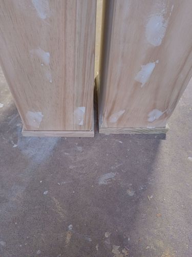

Fill any unsightly gaps.
Cut a couple of pieces just bigger than the footprint of the legs and attach to the bottom. This will give you a nice stable base.
Sand. You can choose your finish level here. From rough to perfect, it's up to you.

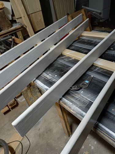

Paint.
I used an undercoat and 2 coats of white enamel for the raols and 2 coats of Dulux Weathershield for the legs.

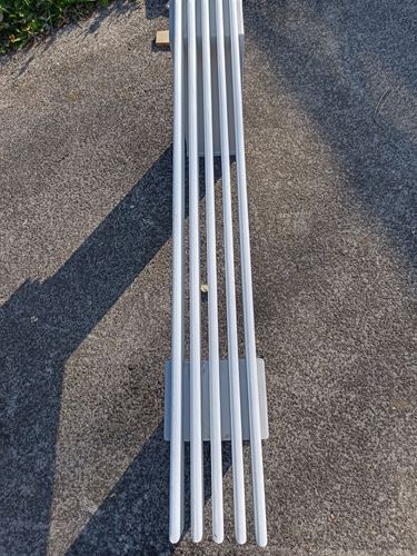

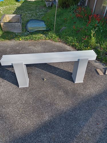

Insert the rails into the legs ensuring the overhang is equal at each end. The fit might be a bit tight, use a rubber mallet to get them right down. The top boards can be secured with screws or glue, or both. I used just the glue.
You're done. Grab a drink and sit in the sun.
