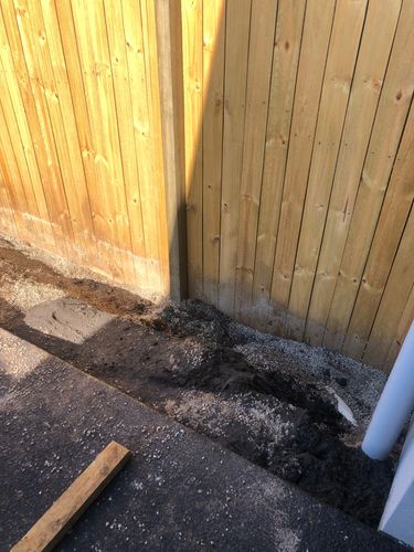

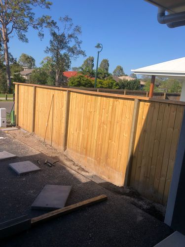

Hi, I followed these instructions but then it didn’t work as the drop is around 400mm so the garden edging was too short. What can I put between the soil and new timber fence to keep the fence from rotting and hold up the soil please? I also have to leave by gap for draining down to the front of the street.

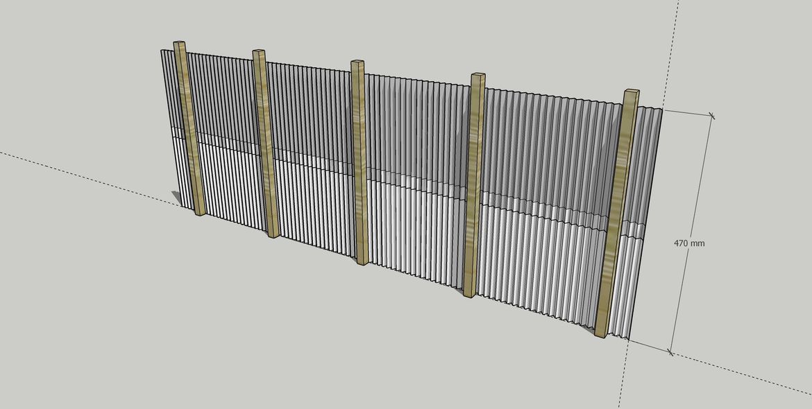

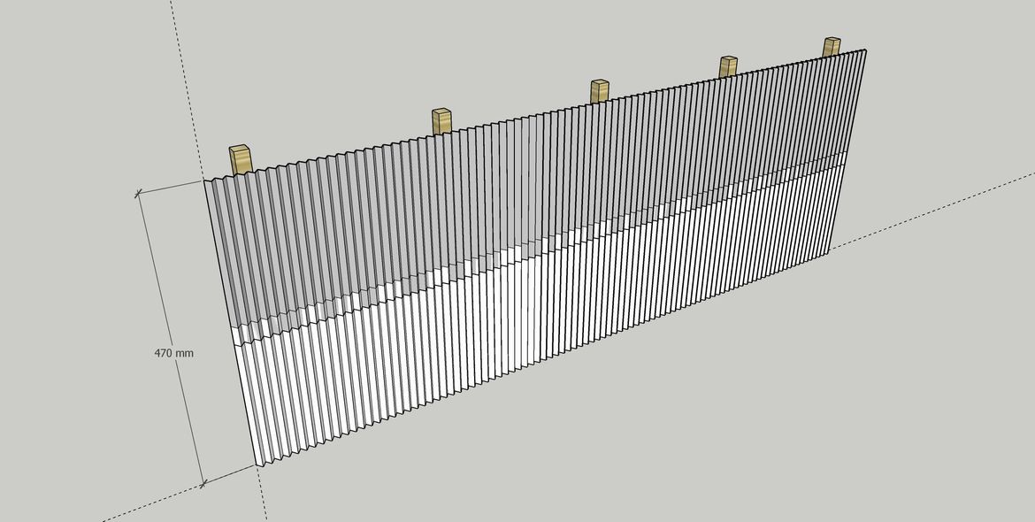

My apologies for the late reply. Due to your height requirements, you will need to double up the Cyclone 250mm x 3.2m Corrugated Garden Edging. You can join them together by using a Craftright Rivet Gun Set. Put the Garden Edging on top of one another and have them overlap by 30mm. Drill pilot holes on both Garden Edging panels and use rivets to join them together. This will now give you the height that you need to hold the soil back.
Please note that the Garden Edging will need to be supported from the back to keep it upright. I suggest using 900mm Hardwood Garden Stake - 6 Pack. However, if the timber posts are not strong enough to hold the soil back you will have to use Whites 90cm Premium Black Ultrapost.  I've placed a sample diagram below for you to look at. If you have any questions about it or need further assistance, please let me know.
