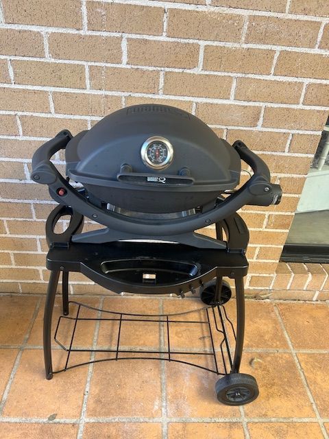

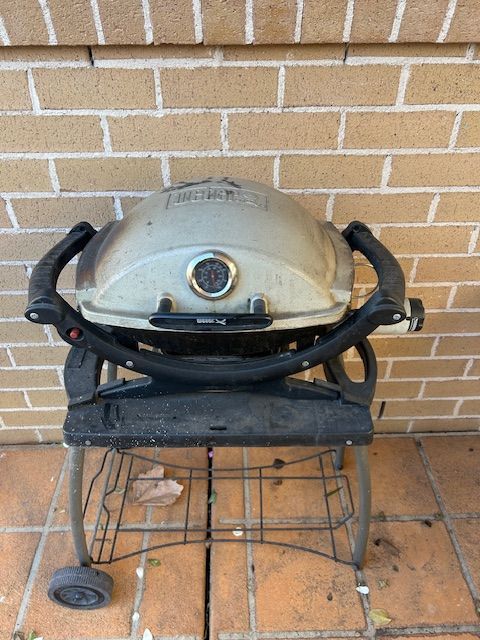

Our Webber BBQ had burn marks on the lid but still worked well so I decided to try give it an instant facelift with speciality heat spray paint from Bunnings to freshen up the extreior and make it look nicer. The stand was also sprayed with just a regular spray paint to freshen that up too.

The difference in the before and after pictures is drastic. It looks brand new!
Congratulations on a job well done.
