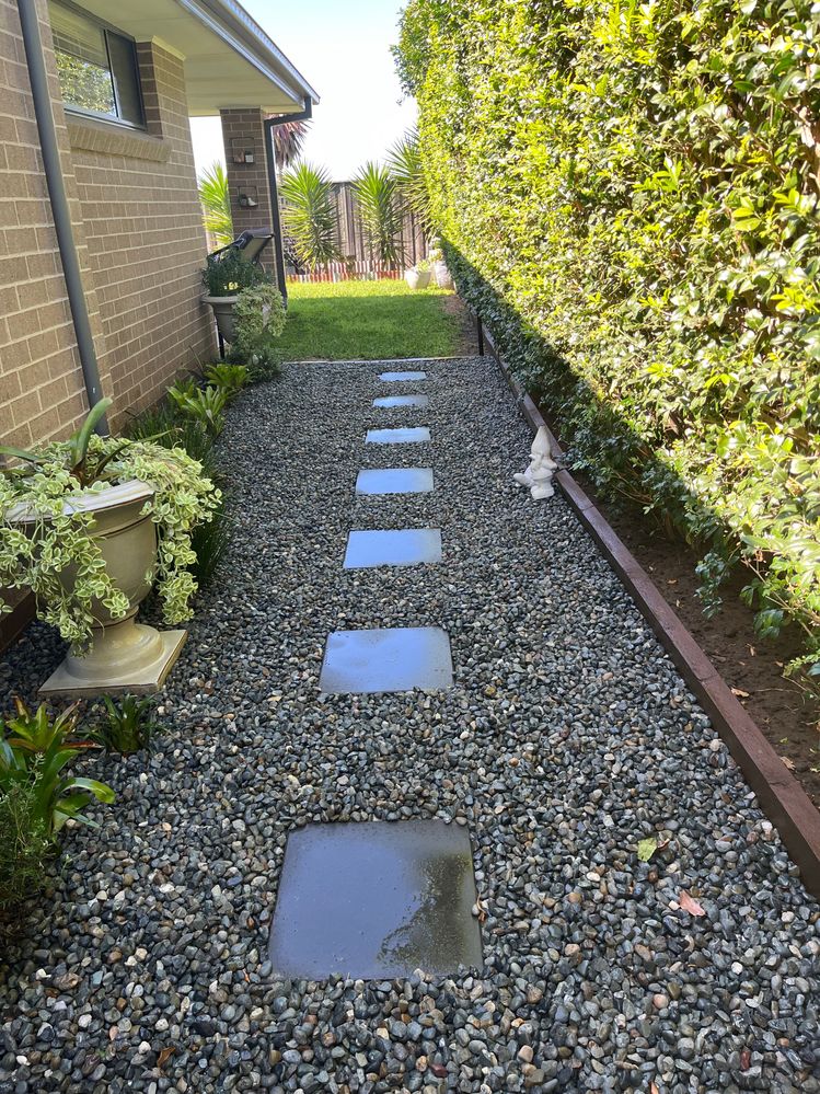

Side passage where nothing would grow even grass so decided to put down gravel with pavers,  bromeliads and a cute gnome
Materials
40x40 concrete pavers
paving sand
gravel
weed mat
garden gnome
Plants
Tools
String line
shovel
level
muscles
Steps
Step 1
Levelled out area
Step 2
Set out pavers equally
Step 3
Put up string line
Step 4
Dug hole for each paver
Step 5
Laid paver sand and compacted
Step 6
Laid each paver and measured between
Step 7
Used level to make sure all pavers the same height and along string line
Step 8
Laid down weed mat
Step 9
Filled area with gravel

Welcome to the Bunnings Workshop community. It's sensational to have you join us, and thanks for sharing your side landscaping project.
This is an excellent alternative to a patchy, muddy area. The pavers serve as excellent stepping points which prevents you from stepping on the soft soil and the gravel provides a nice material contrast and cover. It's a great idea and adds street appeal to the house.
