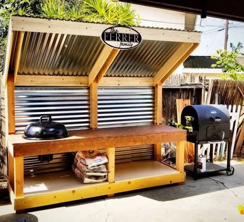

If I wanted this kitchen set up to be 2500mm wide, 600mm deep and 1850mm tall, with the awning being on a 45degree incline and 500mm, is there any chance someone could mock up a cutlist for me? Using timber, thanks :smile:

Welcome to the Workshop community @jherren. I'd be pleased to help assist with your list.
I have selected the materials based on them being suitable for exterior use. The pine is primed and ready for paint. If you were interested in the raw pine look, the same sizes apply but not the links I have supplied. Please note that untreated pine is not recommended for exterior use.
Primed Pine Posts 88 x 88mm- Three posts at 1.8m (rear uprights) and three posts at 0.9m (front uprights).
Primed Pine Boards 138x 18mm- Six boards at 2.5m (front and back of base/roof), four boards at 0.6m (sides of base) and six boards at 0.8m. (Roof supports, extra length on docking cuts to allow the 45 degree cuts to be made afterwards. 0.5m between cuts.)
Hardwood Marine Plywood 2440 x 1220 x 18mm- Two pieces at 600 x 2440mm (top and bottom bench/storage). Note that due to your selected length of 2.5m, infill strips will be needed to make up the difference.
Corrugated Zinc Steel Roofing- Three sheets cut to 2.5m (backing), two sheets 3 pcs cut to 550mm (roof).
Treated Pine Screws 50mm- Screws suitable to use with the treated pine.
