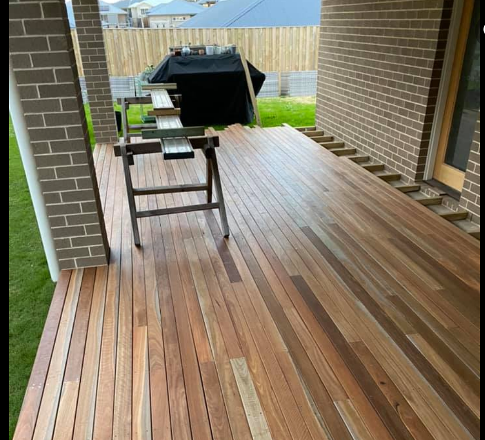

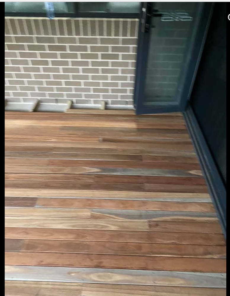

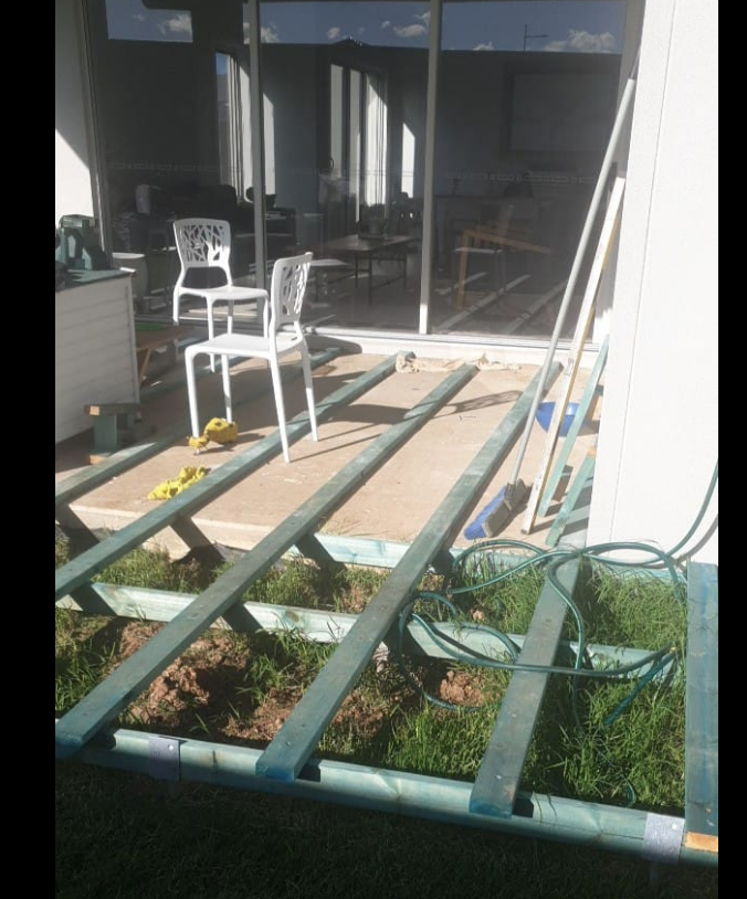

Dear @EricL ,
I was able to scour the internet and seacrh for people who has built their decks when working with a 70mm height.
If you look at the middle picture, the most dirtiest is from a builder who was building their display home. In all the three pictures they put the widest part of the joist facing up. So if i did that and put the joist much closer together, will that work. I believe the placement of the joist is 40cm apart isn't it? I'll put mine at the 30cm apart to prevent wobbling ![]()
Hi @khusnil_deo,
I apologise for the delay in my reply.
You can place your joists in whatever orientation you choose. However, they are more structurally sound placed on the thinner edge, as @EricL has pointed out. Decreasing their spacing would be a good way to get around this issue.
