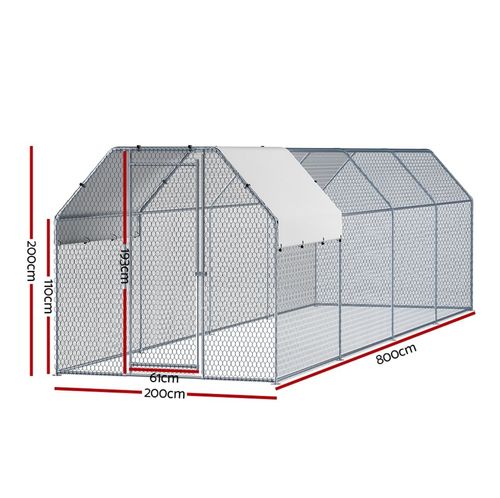

I’m in the process of putting together an outdoor cat enclosure and I’m struggling to come up with some cost effective ways to provide my cats with stimulation. This is the enclosure I’ve used, but instead of the standard plastic chicken mesh I’ve used snake/mouse mesh.
