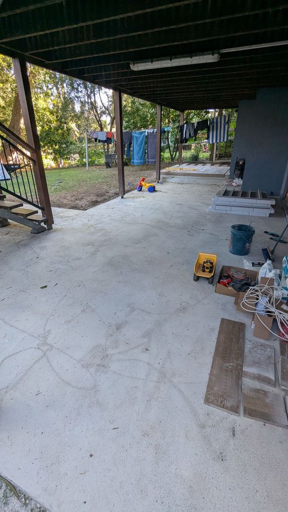

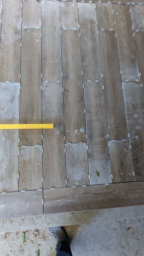

we have are in  the middle of a tiling project where we will lay new tiles ( 20 x 120cms) on a concrete patio in a stretcher bond pattern (as shown on picture 2 on upper slab which 2.5 x 2.5m) .
The lower slab concrete patio will follow the same pattern as the upper slab and is ~ 4x8 meters
I m have been wondering about expansion joints and how far this would be required for the lower slab (not planning for upper slab) -any advice ?

Since your upper slab (2.5 x 2.5 m) is relatively small, it might not require a joint if it's isolated and doesn't receive significant sun or movement, although it's still best practice to provide perimeter relief. For the lower slab, a 4 x 8 m area should absolutely have expansion joints at minimum one running across the width (dividing it into two 4 x 4 sections), and ideally another one lengthwise (making four 4 x 2 sections).
If your patio is fully exposed to the elements (direct sun, rain), these joints become even more critical. Use movement joint profiles or flexible sealant joints and make sure to integrate them cleanly into the stretcher bond pattern, possibly aligning them with grout lines to keep the appearance tidy.

our patio is not exposed to the sun at all so i m guessing one expansion joint to divide the lower slab into 2  4x4 sections makes sense . I do not want it to be a straight line as it would mean a lot of tile cutting and the straight line would stand out in the middle of the pattern . i assume i can just follow the pattern and zigzag along the tile then ?

Yes, that will be ok to just follow the pattern. As long as you are confident that it will not get a lot of exposure movement should be to a minimum.
