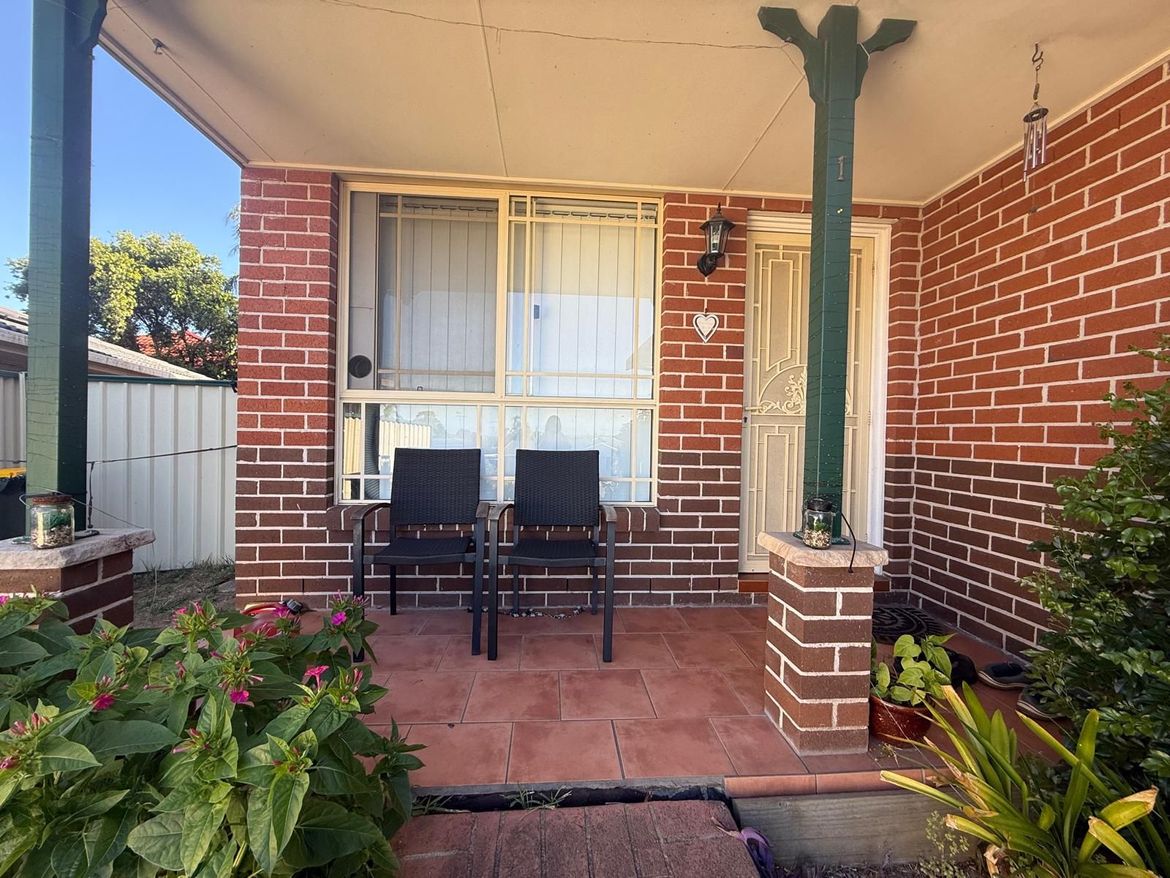

Just wondering is 'Dulux 300g Metalshield Multipurpose Spray Paint Manor Red ' suitable for this patio floor?
Re: Paint type
Hi @kavi,
No, Dulux Metalshield is a metal paint which is not suitable for painting floor tiles.
The only paint I am aware of that can be used on floor tiles, unfortunately, cannot be used outdoors.
If you'd like to change the look of your patio floor, you may need to remove and replace the tiles with other outdoor tiles or paint the concrete beneath them.
Let me know if you have any further questions. I am happy to assist further if required.

So could you please tell me which type of paint I can use for the floor?
Re: Paint type
Hi @kavi,
Unfortunately, there is no paint that is suitable for painting outdoor tiles.
As mentioned, your options are removing the tiles and replacing them, or removing the tiles and painting the concrete with a concrete paint.
