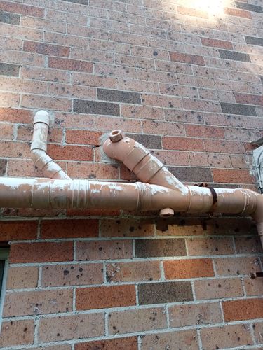

Hello!
Thanks for your quick response. Do you think trojan 250mm wide mouth wrench can also open the two caps on the pipes in the picture below? Or would it slip as it's more of a circular cap?
Is there a special type of wrench or pliers suitable for opening these caps??  I don't hv the dimension/brand of the caps, but the pipes would hv been put in during the late 80's.
Re: Whats the best tool for removing these caps?
It might catch on the ridges @Eddy222, but for those caps, you're likely best off with the strap wrench.

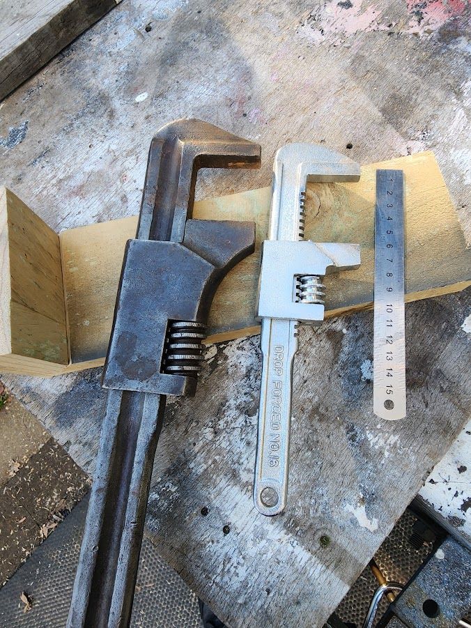

Regards the top image - I swear on a stack of bibles the wrench on the right was called a PVC nut wrench when I bought it.
But the similar one on the left, much bigger, looks very old - before PVC?
Still available?
