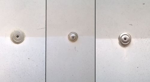

Hiya. I need to replace some rivets in my 1977 Viscount caravan.
Are these pop rivets?
Which is the best riveter tool to get?

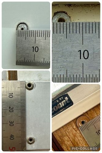

Hi @CrikeyCoral,
It's great to see you've already received some fantastic advice from @twocutekelpies.
Yes, these are pop rivets.

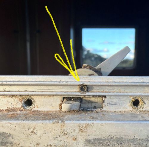

I would agree that sealed rivets are what you are looking for, as they will create a watertight seal. For the rivets in the first three photos, I would try these Otter 3.2 x 6.4mm Sealed Aluminium Blind Rivets, which have a 6.4mm grip, which looks about the same as what you have. For the fourth photo, try these Otter 4.8 x 9.6mm Sealed Aluminium Blind Rivets, which have a 9.6mm grip.

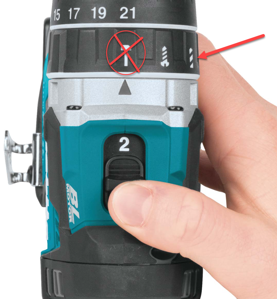

Hi @CrikeyCoral,
You can use a riveting attachment with your drill; you just can't run it on the hammer function while riveting. You need to use the drill function.
The hammer function adds a percussive action to the drill, which could cause issues. The drill simply rotates the chuck, which won't cause any issues.
If your drill doesn't look like this, can you let me know which specific model of Makita drill you have, or upload an image of it so I can point you to the right setting?
That’s looks spot on to mine! Thanks Jacob, that all makes sense, I was being a little overly cautious!

So, just to be sure, before I get all drill happy, to remove this rather mucky, but still functional window lock twisty bit that is riveted to the frame…I drill it out?… @twocutekelpies @JacobZ
Hi @CrikeyCoral
I think you're on the right track but I don't have any experience with that type of lock, my Viscount has the previous model ones. The lock you have was specifically made by Viscount and is no longer available so be careful not to lose or break them, they are different to the after market ones that are available now.
