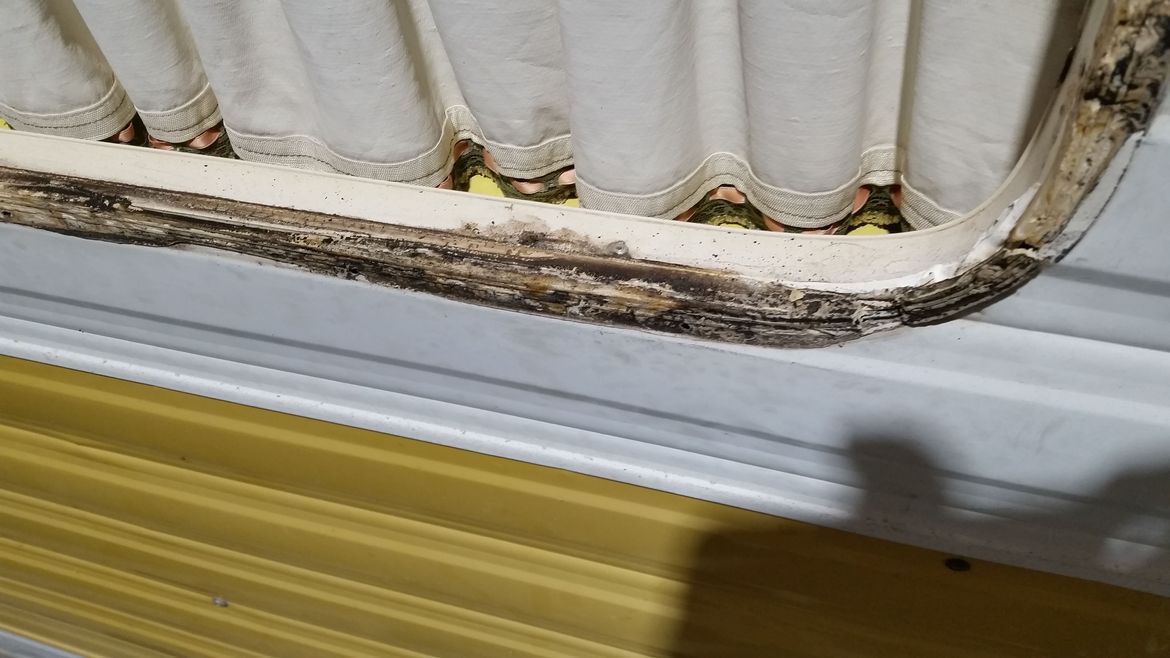

It is most important to remove all windows and replace the sealant between window and wall. Water penetration will cause the internal wall timber to rot out.
Just placing silicone or similar on the outside will not fix the problem as the existing paint would be oxidised and powdery. There are much better methods for sealing windows than silicone. Window sealant on Viscount leaking

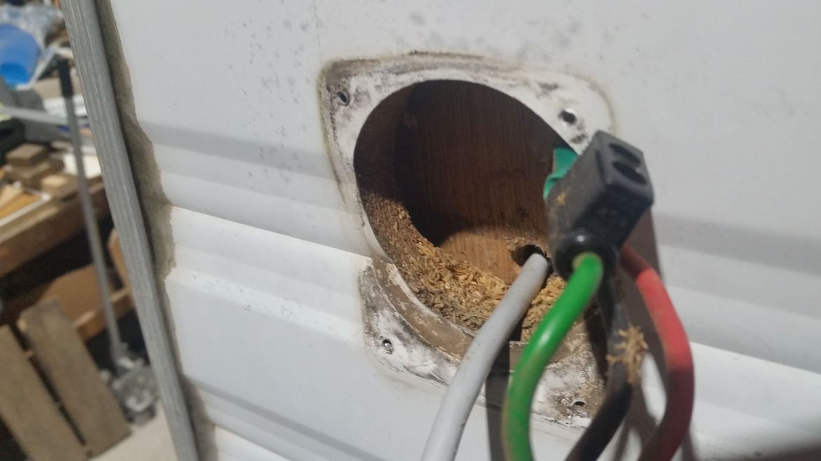

Particle board mounting in wall behind power inlet disintegrating because of water leaks.
The two above photos illustrate where water is leaking in. The blackened sealant is the result of dirt washing in with the tracks of water.

Vacuum the dust out and soak that particle board with a diluted Bondcrete mixture to seal it up. 60% Bondcrete and 40% water, paint it on, let it soak in and dry then give it another coat.
