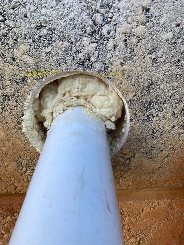

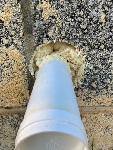

Hi. Next part of my DIY is to finish off the outside. I have used expanding foam to fill the void. Now I need to finish off the appearance from the outside with a cement limestone finish to make it flush with the limestone block. Is there a ready made cement product or should I just mix up a cement slurry to finish it off.
Re: drainage grate sealing
Hi @neal,
I'd suggest you use some Dingo Fast Set Mortar for this repair.
If you'd like to colour it, you could use a bit of Dulux Avista Oxide Sandstone Cement Colouring to get it closer to the colour of your walls.
Mix the mortar to a stiff consistency, thick enough that it will stay on your trowel when it is held sideways, then apply it and smooth it off.
