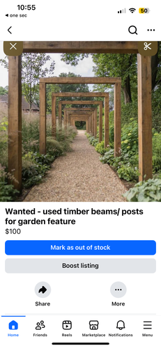

I have collected a number of weathered treated pine beams (picture 1). I am wanting to make some garden arches out of them (picture 2). I would like to bring them back to a nice brown colour, and maintain this colour going forwards. What is the process to bring the weathered grey posts back to a nice brown colour and how do I look after them to stop them going grey in the future once they are in place in the garden?
