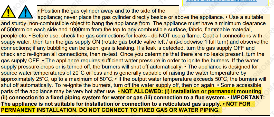

The instruction manual, which can be found here - ThermoMate Gas Water Heater with Pump Instruction Manual - states that it is "Not for permanent installation. Do not connect to fixed gas or water piping".
Based on the manufacturer’s instructions, leaving the unit installed outdoors for extended periods or integrating it into a mains-connected outdoor shower setup would not be possible.
Unfortunately, you would need to speak with a licensed plumber for their assistance in installing a system that is up to the standards required.
