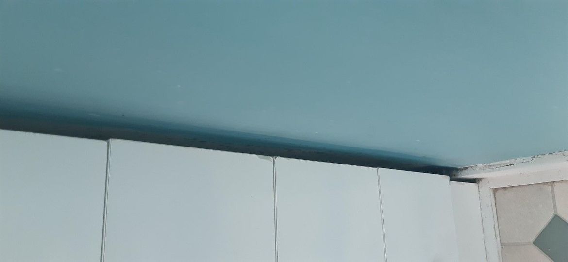

Am renting a house that has a few gaps. What is the best product to use to fill these random gaps?
Above kitchen cupboardsAbove kitchen cupboardsNext to vanityNext to vanityFloor next to bath currently covered upFloor next to bath currently covered up

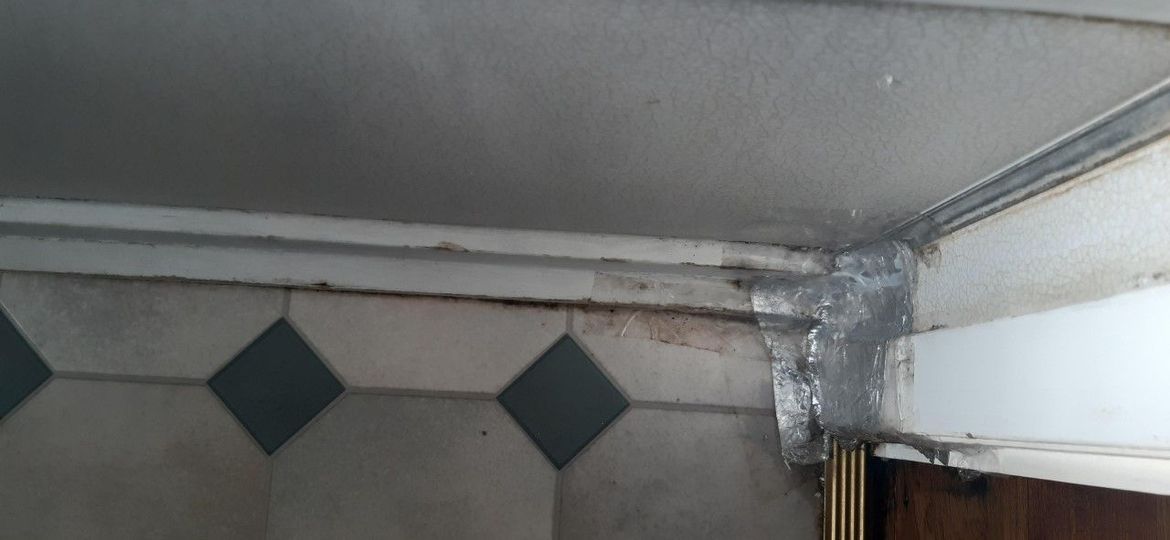

Thanks Mitchell. I am looking for a long term solution. Particularly in the bathroom where there is a hole in the floor that I have just covered up to stop the water from the shower leaking downstairs.

Hi @ShazAtSea
Many thanks for clarifying as any permanent solution would require changes to the property which generally wouldn't be acceptable under lease conditions.
The gap you have shown above the cabinetry could be filled with timber and painted to form a permanent solution. The filling piece can be glued or screwed in place. The gap down the side of the vanity isn't leading anywhere and wouldn't normally be filled. Once again a piece of timber would make it look neater.
I would need to see what type of gap is under the plastic to advise on the bathroom floor. I would hazard a guess that a gap that allows water to leak from the shower downstairs should be repaired by a tradesman organised through the real estate or homeowner.
