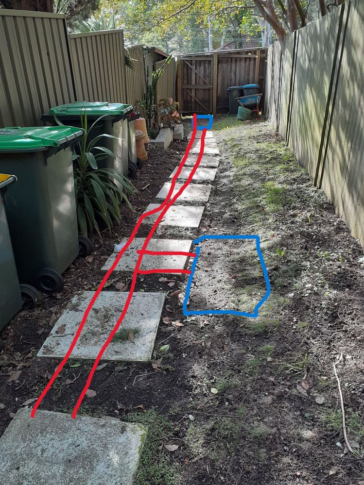

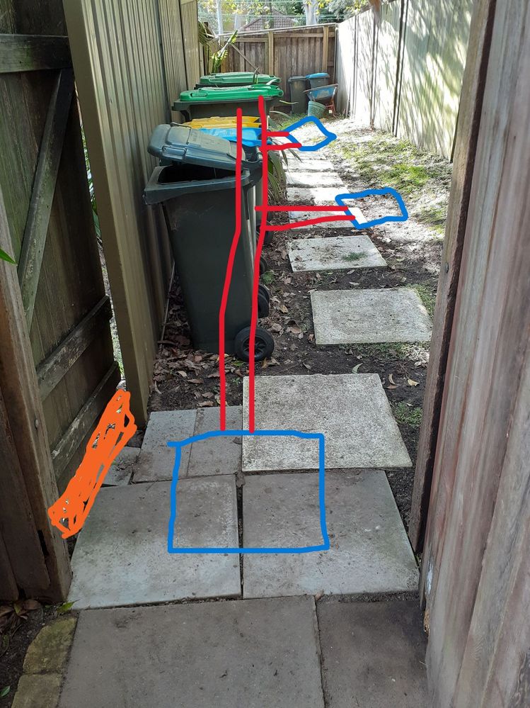

I have been considering the vast range of options to manage the lane. To start with I have measured out and considered using the everhard channel drain however the line of the current waterflow is not directly linear (nor is path) and the bulk of the water is rushing into the lane at the top end of the path with all the concrete pavers. Furthermore a 15m run of everhard channel drain with elbows etc will be rather expensive. I am now considering installing a stormwater drainage system with a large stormwater pit (450 or 600mm square pit) in place of the 4 concrete pavers with 2 other pits along the lane (likely more 300-450 sizes). This way the discharge water pipe can be in solid 100 or 150mm pvc under the soil and can have the pits branched off to reach the low points in the natural run off of the water. I have an embankment outside the lower end of lane that I can safely discharge the water to. I am also really hopeful that once this is set up and the rate of water flow down the natural swale is dramatically reduced I may have sufficient water control to get turf to be happy in the lane as well which will improve the appearance and also help with preventing soil erosion. Finally I plan to install besser blocks (https://www.bunnings.com.au/brighton-masonry-390-x-190-x-90mm-full-besser-block-100mm-series_p345047...) along the side of the colour bond fence to avoid water ingress under the metal fence as well as providing a raised step to the gate to funnel water run off to the pit.Raised step (orange) for timber gate to contain runoff to lane showing large stormwater pit and 2 other pits downstream connected by discharge pipe
Further down the lane showing middle pit and end pit to collect water runoff - not sure if bottom pit will be necessary - red line showing water discharge pipe

I looked at my lane tonight and found it has huge fall (about 7% gradient down hill - 1m fall over a 13m horizontal run). I am reluctant to do the pits as it involves so much excavation for plumbing, lifting all the pavers, reshaping the topography etc...whilst the lane has functioned reasonably well without any storm water drainage for the last 40 years I have seen it. The everhard drainage system looks nice but on a 15m run (a few 90 degree bends for better coverage) it adds up to about $550 and it also needs a large trench cut with concreting around it. I have considered an alternative option which is closer to the spoon drain idea but using PVC pipe. I have considered cutting 100mm or 150mm PVC pipe down the centre as well as a few Female-Female 100mm or 150mm (depending on pipe gauge chosen) 90 degree bends and gluing it all up with pvc glue on a shallow concrete or gravel bed. That way the water can exit the run at ground level happily, there is no serious extensive excavation required and being pvc it will happily allow bins the ride over it etc. Also means that I don't have to get creative in shaping 15m of concrete spoon drains. This guy is using a half width pvc pipe as a goat feeding trough but essentially it shows what I am considering. Let me know if you think its a crazy idea but as I have some spare 100mm and 150mm pvc, spare pvc glue and wouldn't require lots of concrete I suspect I could do the whole 15m run in about $100-150 budget. Only main difficulty will be cutting the pvc down the centre with a hacksaw but sure I can manage it. Also being an open top spoon type drain would theoretically be easy to keep clean of debris and allow grass to grow up to it. https://www.youtube.com/watch?v=SE71LgdjW1c I would appreciate your thoughts. Maybe I'm just better to go with the everhard drainage system? Many thanks for your ongoing guidance. I have also attached a plan for everhard drainage install for an alternative approach. For the water exit point it is out onto a steep tall sandstone clad embankment so I could exit this way to the street in a safe fashion as other stormwater pipes exit in the same way from my place.

Your laneway is pretty much the same slope as my front yard. I do like the idea of a dish drain of some kind but think the idea of using the PVC pipe cut in half may not work so well. As in "effort involbed = poor return"
The paver drain would be a possibility but will still require some digging. Its an open top drainwhere you have the center run of pavers lower then the pavers for the rest of the area. So profile wise paver then a step down to a lower paver and then step up to the same level paver as the first. This will give a chanel for the excess water to follow and not scour the land.
At the moment your pathway looks like the low point is down the center in line with your pavers, this is why digging either side out may have to happen. This drain should really be on the side and not in the main foot traffic area as the pavers either side of the drain are not fixed, but placed insitu.
When I say paving dish drain I mean you use pretty much only 3 pavers wide. The two topmost pavers overlap the bottom paver to give a channel for water to run down. The drain needs to be the lowest point across the path.
The funny blue shape is the profile of the step drain. Flat, then one paver lower then back up and one paver (With the top pavers overlapping the bottom one). The long blue twin lines are where Id suggest to place the drain. The bins can sit over it and still the drain will do its job, The digging will be lowest as its mainly shift the large pavers to the right and you will need to level that.
If you go with the cut PVC pipe id go for straight runs as more corners will proberly cause issues. One thing your idea did make me think of is instead of PVC pipe (I know you have some already ) you could go down the track of using a wide metal gutter or old channeled roofing, as long as it has the same chanel ability it should work.
