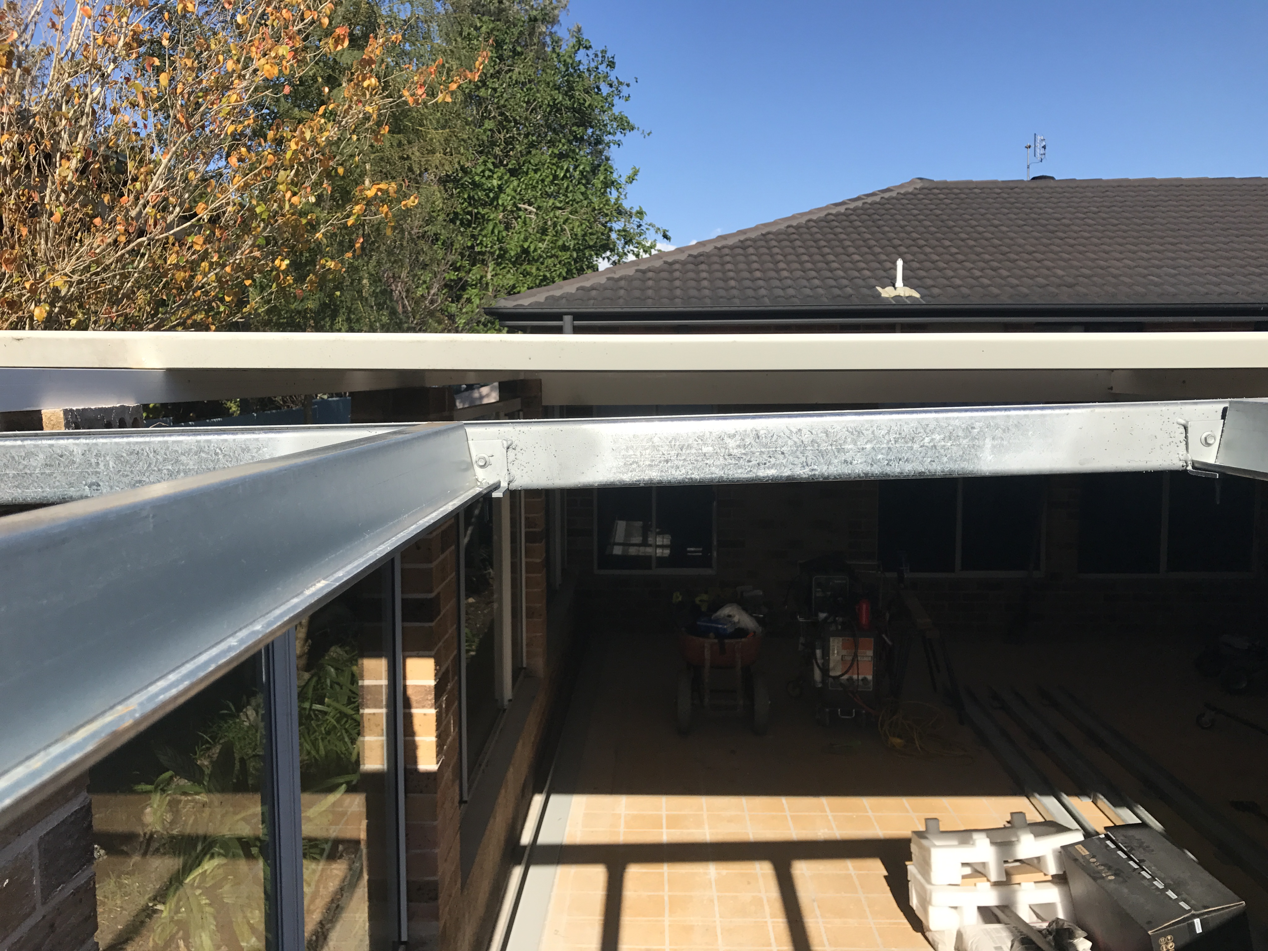

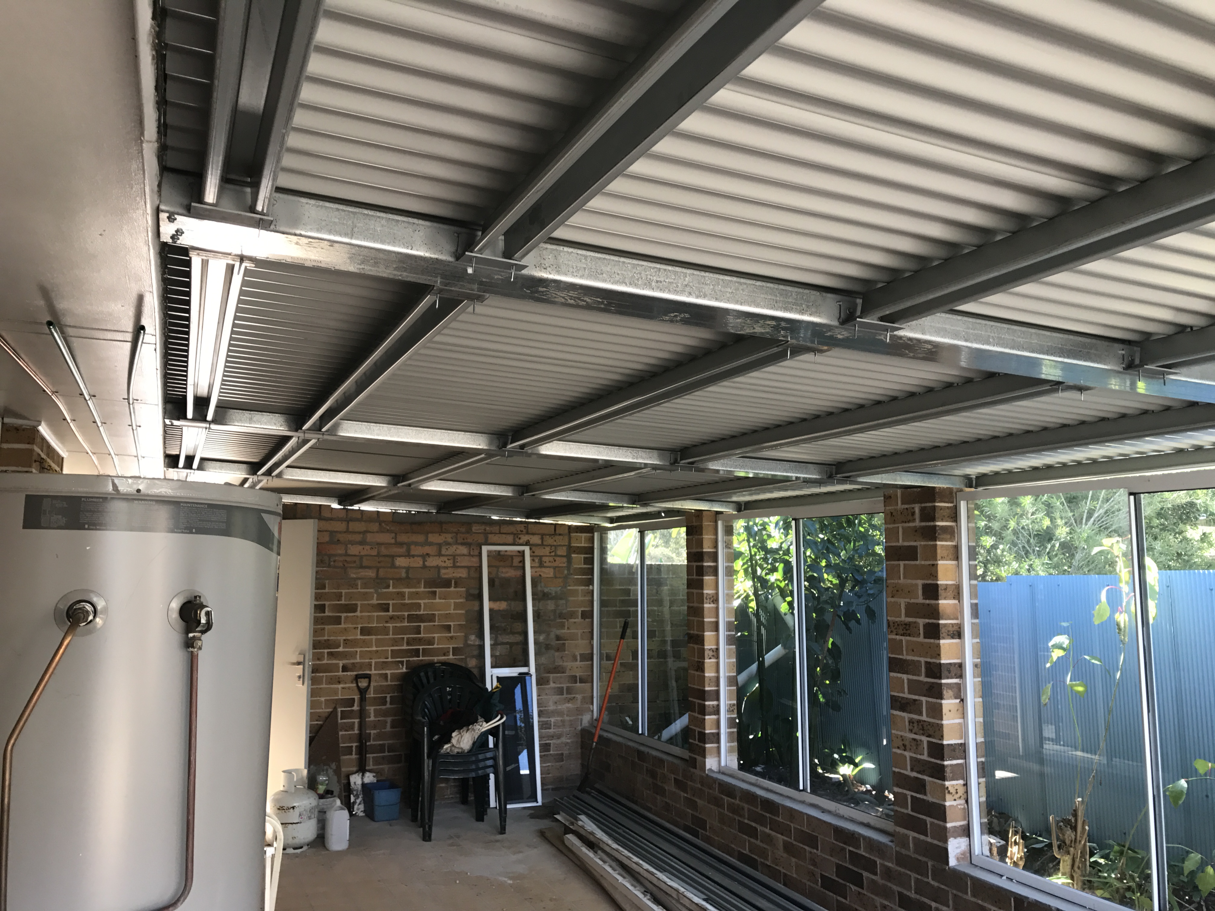

Here is where I am at right now, progress is a little slow but I want to get it right the first time and not have to come back and redo something, so far so good, everything is working out to plan. I now have a decent fall on the new roof and it is very strong and sturdy we have already had a couple of gale force windy days and not even a squeak let alone a rattle from the new roof unlike the old one. You can see in the pictures the new roof is much sturdier and will support me without any movement at all, the older one I dare not set foot upon it even with spreader boards. The main beams are anchored with 2x12mmx150mm chemset into the brickwork, unlike the old one which was 1x8mm booker bar cemented into the brickwork. I found the gutter attatched to the house facsia was siliconed and with a tek screw every metre and a half, yes the first section was hard to remove but the next section virtually fell off so something was starting to fail. I do have one leak but that is to be fixed at the first opportunity I have and did think it might leak in that spot, but I want to get the roof complete and will then fix it.
I know I have posted this first picture before but it is a comparison of the old roof and the new, as you can see there is very little support only what is designed into the sheet roof itself. The second shows the new roof and support it now has and the end window has been removed and bricked up ready for the new split system. In the third picture you can now clearly see the improvement on the fall of the roof.IMG_0191.JPGIMG_0177.JPGIMG_0186.JPG

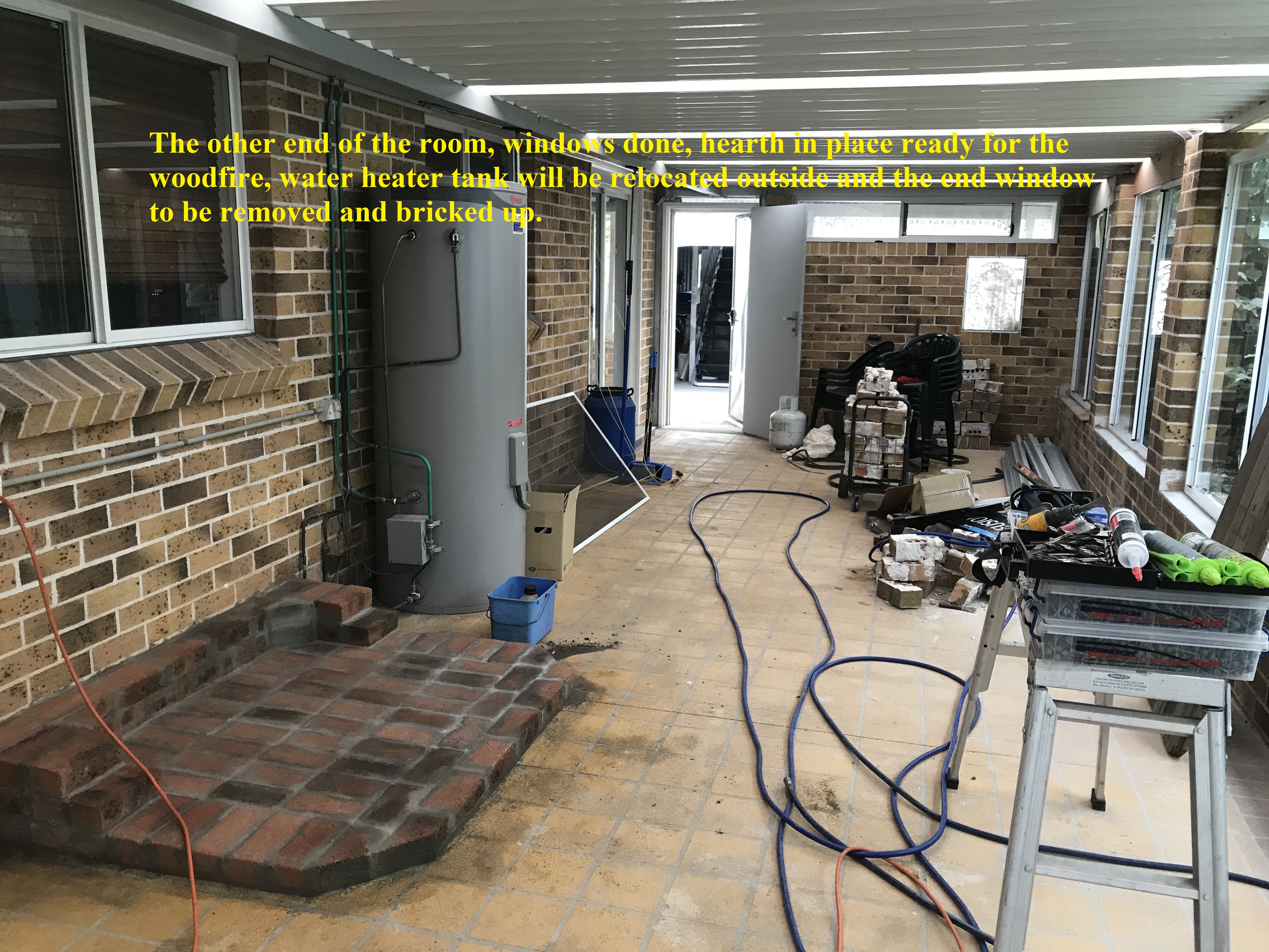

Thought I would give a quick update, well nothing has been done since my last update due to gale force winds not the best weather for roofing and a bit of time out due to the passing of my Mum. It has been a bit of a rough couple of weeks to say the least but she is not suffering anymore. I am hoping the next week or so the winds will calm down and I can finish off the roof, I have the new fire in place but can't do the flue as I am waiting on the delivery of the roof seal kit, if the wind stays and I get the seal kit I will finish the fire and cure the fire bricks over a few days as per instructions. Well that's all for now I will keep you all posted on future progress as it happens.
