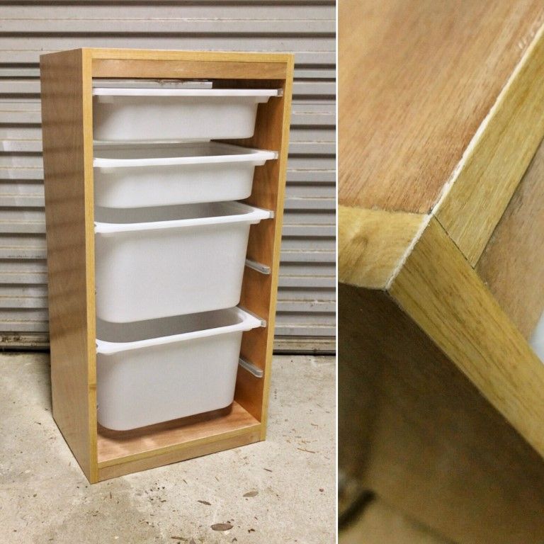

All in all, I'm pretty rapt with the result, though my edge banding job was fairly dodgy, but the kids love it, which is really all that matters.

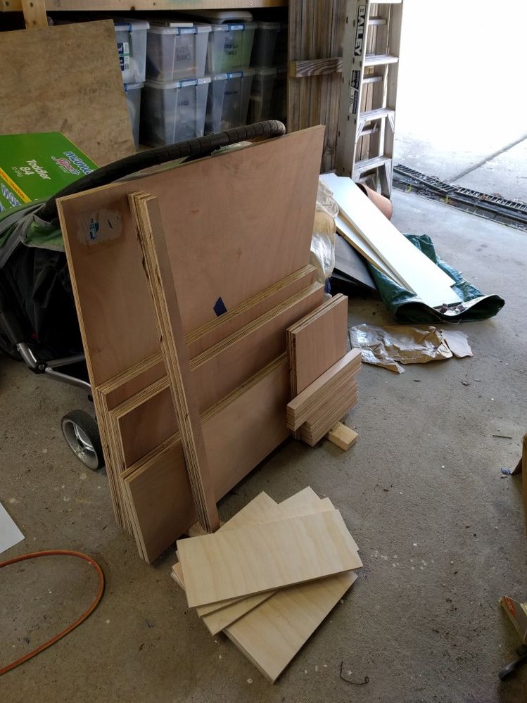

All the plywood cut to size

By the way, you're unnecessarily harsh on yourself by saying that your edge banding is dodgy. I'm with the kids, I thinks it's perfect.
I also love that you used C chanel aluminium extrusion as tracks for the slide out bins, I've used them for other purposes, but I'll definitely take on what you've done in future projects.
