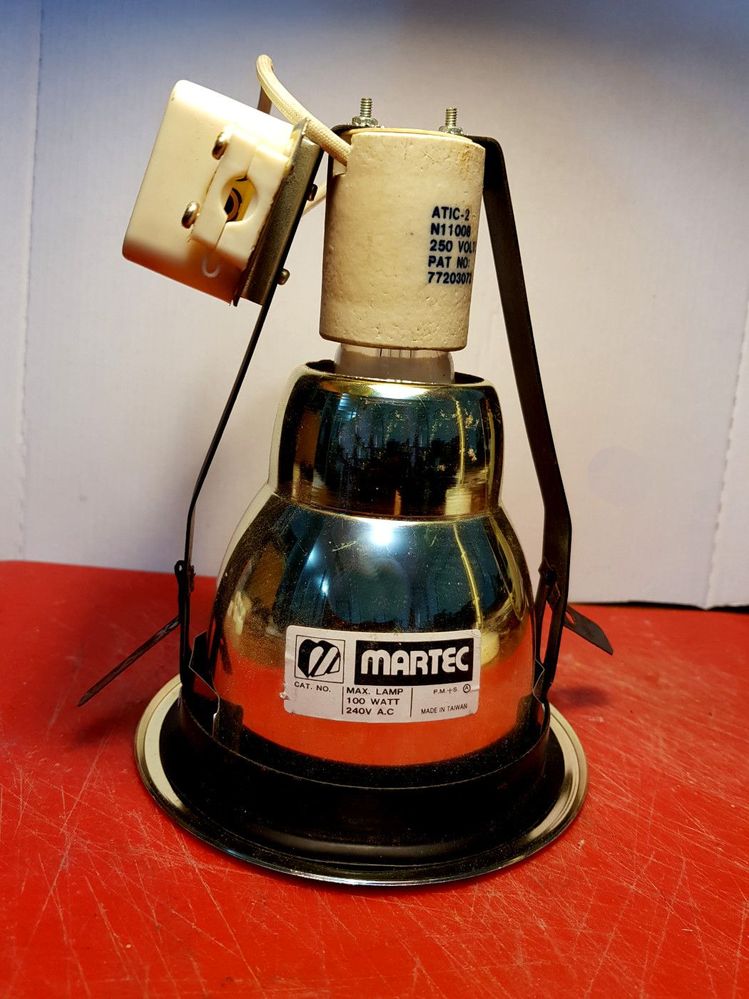

@Sugar Your existing downlights were popular in the '70s and are roughly 150mm diameter with a 110mm cutout in the plaster ceiling.
Typical 9 or 10 watt LED downlights fit a 90mm cutout, and are 110mm diameter.  Which means that the LED downlight will go straight through the opening!  There is a solution though - you need to fit a conversion plate in each hole and clip the downlight into that.  ($11 per light)
 https://www.bunnings.com.au/hpm-130mm-white-downlight-extension-plate_p4390437
The show stopper for you will almost certainly be that each light is hardwired (ie: permanently connected).  You MUST hire an licensed electrician to remove each light fitting and replace it with a plug base similar to this.  ($3.22 per light)
https://www.bunnings.com.au/deta-10a-miniature-plug-base_p4430736
New DIY downlights can then plug in to these new plug bases.

FYI: Just for interest sake I have posted a couple of photos of a common '70s downlight (it's actually new, never used). Its probably the same as your except it's polished brass.
