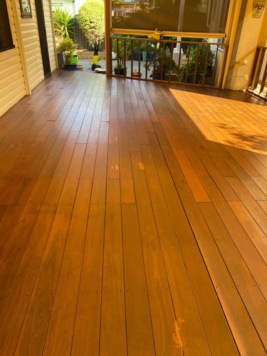

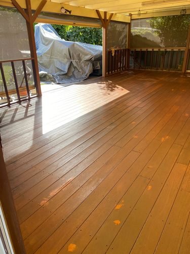

Many thanks. I gave finished putting aqua deck coats.  It looks good.  And I am not going to use polyurethane as it is oil based and plus your recommendation.
what I am annoyed by us the filler I used which was supposed to be me eBay but left visible marks. It was intergeain beand.
Can’t cover it.  Attached sone photos.

I'm sorry to hear that the filler did not match your board colouring well, @khwajas. Was it the Intergrain 180g Jarrah / Merbau Woodblend Putty? Apart from sanding the filler back and recoating the deck, there's not much I could suggest to resolve that issue.

What sort of damage were you filling, @khwajas? It doesn't relate to the colour difference, but there appears to be a fair bit of filler left on the surface of the boards. Were all the holes that large, or would sanding the area flat and removing the filler from the top of the board where it would not be needed reduce the amount of filler in those areas?
The problem with fillers is that there's only one colour for Merbau, whereas timber from different suppliers, or even from the same tree, can consist of various colours. My Merbau deck has different boards ranging from a red hue to a darker brown. Any one filler would not match well with all the boards.

Thx.  The deck builder was a useless guy he installed some of the timber which had large holes. I tried to sand down.
