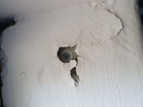

I am in a rental, and gained permission to hang curtains and remove the revolting verticals. Recent surgery prevented me from doing it myself, my niece assured me she had it down pat.Failing to use brackets supplied with rails.
Dilemma ; she hadnt a clue, actually, i now need to repair wall, and rehang rails in correct position.
Ive worked with pallets, painted, built lots of things, but never hung curtains. Could someone please give me some easy instructions, and repair tips.

Here are my issues.
Its plaster over brick wall, about 30mm plaster.
Aluminium windows, no acrcatrave, set directly into wall.
So i need to patch holes,  which screws would be best, and im assuming i need a masonry bit.? I'll be placing brackets above and offset from existing window frame.

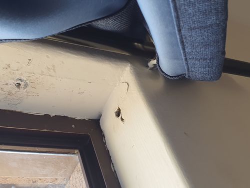

I am also doing the curtain for my windows.
Bought curtain rods and removed my old one. Now I have to drill holes into the wall above my window. To do this, i got a stud finder to check the studs inside the wall (plaster). But my question is , can i drill screws into my studs?? or should i always drill them in the gaps around the studs?.

Hi Anthonygus,
Thank you so much for your reply. I will get the wall anchor screws today.
However, in the mean while i drilled a screw directly into the wall and obviously, it didn't work. So will resume soon with your advice.

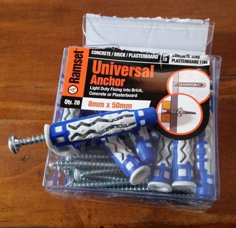

I must admit I haven't tried them yet - but they look interesting. Universal expanding wall anchor...(from Bunnings).
