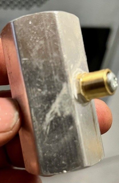

Thanks, Jacob. The manual doesn’t mention anything, and I’ve contacted the manufacturer (Chef), but they just directed me to an overseas call centre. Unfortunately, their suggestions were all over the place and unrelated to my actual question — pretty frustrating, to be honest.
Just thought I’d put it out here in case anyone else has an LPG oven and might be able to offer some insight. Picture.png.jpg
I did get this with the oven but the instructions dont say what it is.

I just called a gas fitter plumber mate and he said it should only need the one regulator it's very uncommon that a 2nd is used.
But also said he would recommend you call a Chef service agent rather than Chef to avoid that overseas call centre issue. It is possible that it may require a specific regulated flow valve rated to match the model you have being an oven not a BBQ on LPG.
