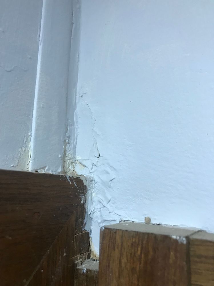

Hi all,
First post here. I have two questions regarding walls and player in the home.
1. What is the stripe for shown in one of the photos? The house is a 1986 transportable house. It’s not very thick so I can’t see it being used as conduit. Does it have a purpose? Can it be safely removed? I don’t look like the look of them.
2. In the other photo is a section of the wall above the door frame in a corner that has really thick plaster. I was wondering if that was just someone’s attempt at repairing cracks before selling the house or not. What would be the best way to fix it up?
Thank you in advance to any help provided :

Would the stripe be there to help conceal the join between plasterboards?
For the second pic, it just seems you have a lot of sanding back to do. Keep going until you get a nice smooth surface. If access is a little tricky, a multitool might help.

Are you sure that the walls are plasterboard. Those type of joint strips are usually found on asbestos sheet houses. Could possibly be asbesto, I would check first and not sand it at all if it is.

@WheresWally my advice was based off your reply of it being plasterboard. If it is a fibrous cement then you need to be following @Jason . DO NOT TOUCH it if it is not plasterboard. I have removed my above post as I feel it may be mis-leading to others. Classically this timber jointing method was used on fibrous cement sheeting and I feel the chances of it being asbestos are too high to leave my advice up.

Sorry for some confusion. The walls I’m pretty sure are gyprock. They are hollow walls on a timber frame.

Pre 1990 house the chance of Asbestos is high.
