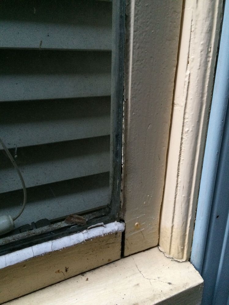

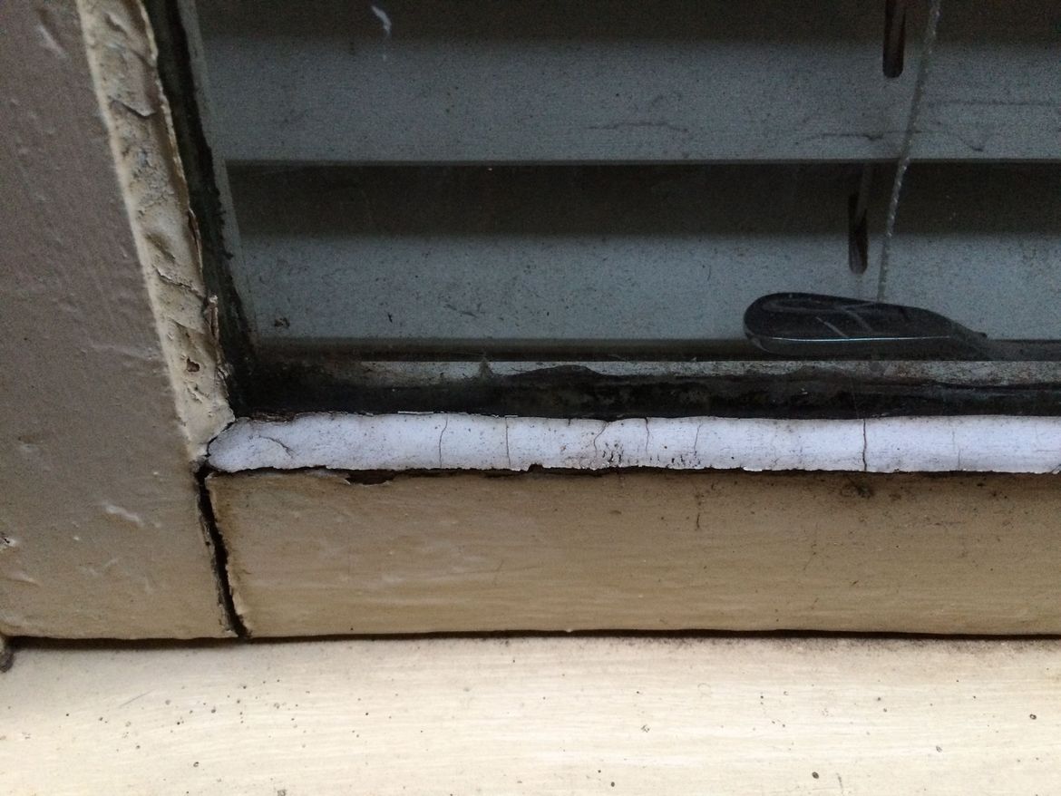

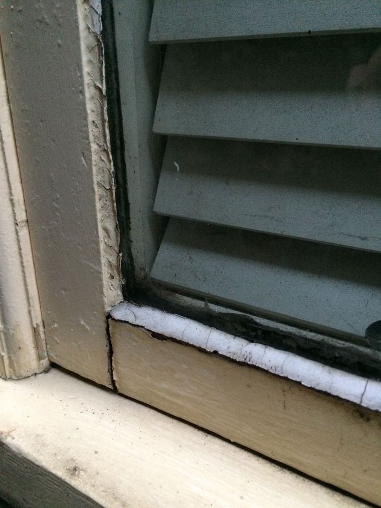

i came across the issue of one of the bedroom windows not being fixed properly in the timber frame, and not sure how to fix it.
I've had a look around and the recommendation is to clear out the old putty and use a linseed putty to fill the gap and fix the window due to the timber.
has anyone had any success with this product, or can point me in the right direction to help?
https://www.bunnings.com.au/selleys-450g-linseed-oil-special-putty_p121014
The old puttyThe old putty
What's falling awayWhat's falling away
None around the edgeNone around the edge
Not the best job first time round by the looks of itNot the best job first time round by the looks of it

Looks like a fair amount of shrinkage in the frame if those gaps were once tight. If you tap the wood does it sound solid or make a hollow sound?

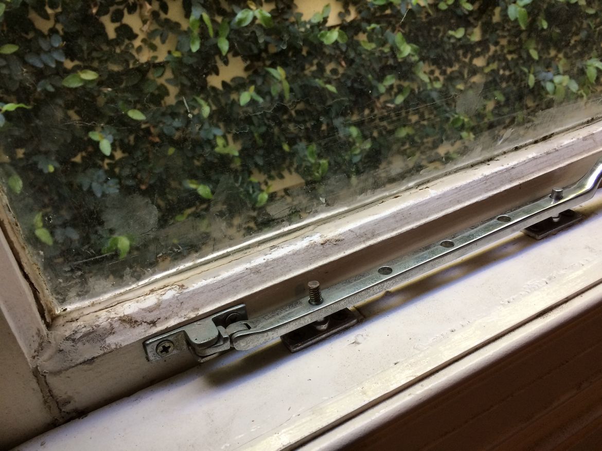

I thought I'd provide an update as I finally had a chance to give it a go this weekend.
i ended up clearing out the old putty, brushing out any dust and applying the putty pretty easily (prob due to the warmth).
The timber window do need to be replaced but just need to stop the draught for now.
Gave it a bit of a smooth out, cleaned up the edges with a scraper and letting dry over the next few days before applying some paint.
Thanks for the help team
