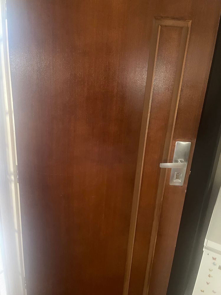

Recently we have changed our Floor colour so we need to change our main 2 door colour . We decided some thing neutral colour.
But our present door is like Varnish colour .
Could I please have some advice how to do that easily ?
Thank you in advance
Present door colour

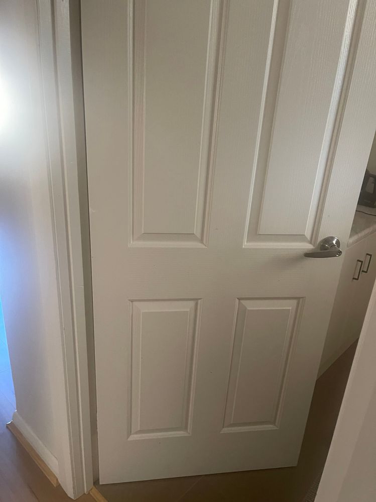

would like to do similar colour
Hi @mmd22
Well your door looks like it is in good condition all you need to do is sand the varnish on the door with 540 Grit sand paper this will clean any dirt off at the same time giving the new paint of any type to bond too, take your door hardware off first for best results or mask up the door handles etc.as like what you must have done for the interior doors that look nice.
But if you want to lighten the front door color varnished appearance I think the fastest way is to sand the door back to bare natural wood this would be easiest done taken off the hinges and put on another table or tressels. Best to use machine sander palm , or general orbital should do start with 240 grit. faster start 90 grit but beware this is agressive paper.
